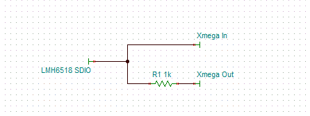

Part Number: LMH6518
I am trying to interface an xmega32D4 with the LMH6518 SPI.
The SDIO pin of the DVGA is a bidirectional pin while the xmega is using independent pins for data input and output.
So i am thinking whether i should use the HW spi peripheral or do it by software.
First of all the schematic in the DS has confused me a bit.
1) During read ops, the DVGA is fed with the clock pulses, starting at the assertion of the CS, of the microcontroller only while the command transmission pulses last (SCLK 1-8).
2) Then the SCLK of the DVGA is the clock source and the microcontroller, from now on, must be configured as a slave in order for the SCLK of the microcontroller to be an input (SCLK 9-25).
3) During write ops, the DVGA is fed with the clock pulses, starting at the assertion of the CS, of the microcontroller throughout the entire 24-pulses sequence (SCLK 1-25).
4) The arrows, in the image below, showing upwards give me the impression that CLK data is sourced by the DVGA towards the microcontroller which would be wrong based on 1, 2 & 3. Do the arrows showing upwards indicate CLK data flowing from the microcontroller towards the DVGA?
