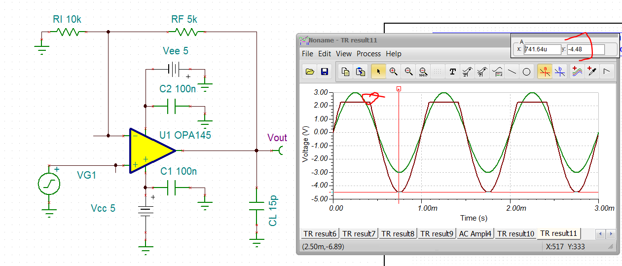

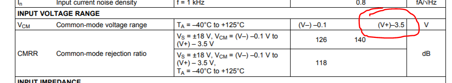

I plan to use opa145 in my design to amplify the 3V signal to about 5V. But when i simulate in TI-TINA and use the  the ±5V supply,the output of opa145 is limited to +2.25V。According to the datasheet,the maximum output should be (v+)-0.1V。I don't  kown why.
The simulation information is as following。
Looking forward your reply.
