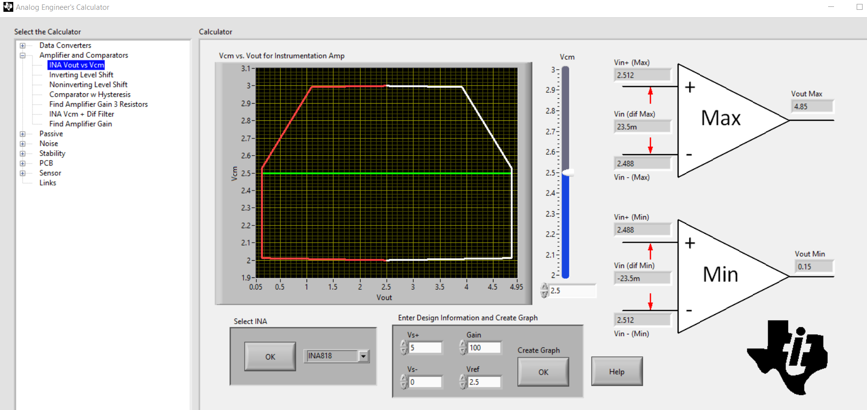

I am applying an instrumentation amplifier to a simple Wheatstone bridge with Vcm at 3V.
And single supply at 5V.
It turns out that in TINA-TI I get a perfectly linear output with the INA333 and INA118.
According to the INA118 datasheet, the INA818 is similar only by improving bandwidth and Vout range.
But I don't get the gain to be as linear as in the other INA.
Is it possible that the PSPICE model provided is wrong? What model should I use to simulate it?
Thank you very much.
