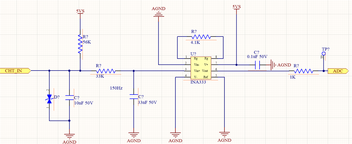

Part Number: INA333
Hi all,
Can I measure RTD sensor( NTC or PTC) using INA333? In INA333, the VIN + pin is connected to the RTD output and VIN - pin is conected to the ground line.Do I have to use differential input or can ı amplification the singel input as shown in the schematic.
I would highly appreciate and suggestions for improvement.
