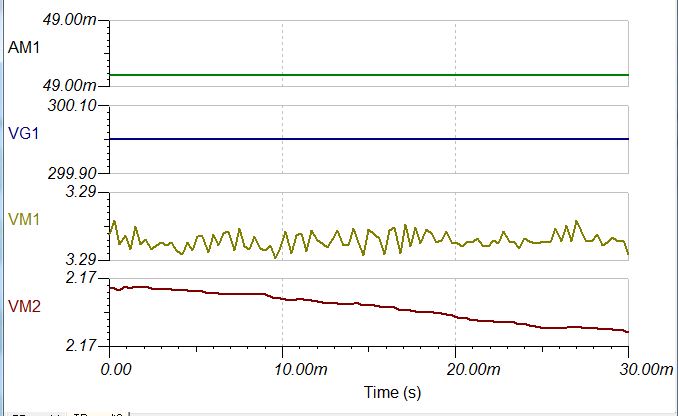

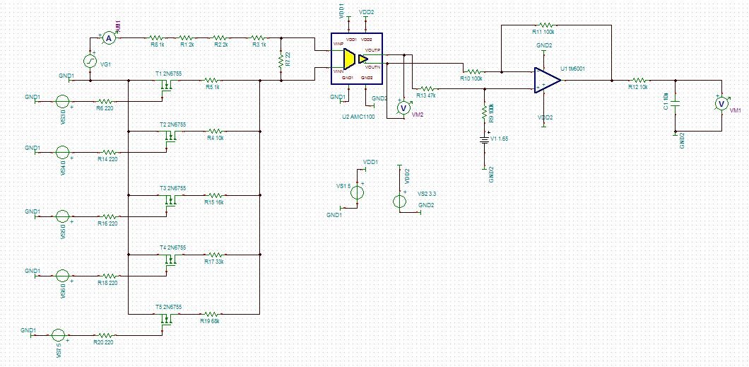

Hi
While simulating AMC1100 part on TINA software for controlling my input current following things were observed.
- Without AMC1100 part connected, on controlling the ON/OFF of the MOSFET, I am able to control the current in the path with the simulated current is equal to theoretical current (shown in Fig 1 and 2)
- With AMC1100 part connected, on controlling the ON/OFF of the MOSFET, the simulated current is not equal to theoretical current (shown in Fig 3 and 4)
It should not happen as the current drawn by AMC1100 is very low as specified in the datasheet.
Kindly let me know the reason for that.
