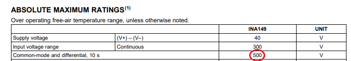

I am using INA149 and have some questions about its operating limits.
I am using it with the following inputs : V+ = 5 V and V– = 0 V, REFA = REFB = 2.5 V
My question is what is the differential voltage rated to? I plan on having a voltage difference of up to 15V for short period of time (<1sec). Can it survive this with no damage? What would Vout’s value be?
