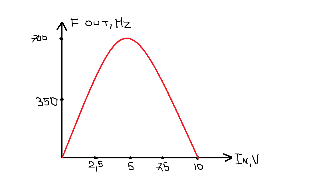

VFC.
VCC = 15-17V
Input voltage = 0-10V
All items are set as in the Datasheet.
According to the Datasheet promise that the output will change the frequency from 0 to 10kHz depending on the supplied voltage, in fact it seems to work, but not quite as I would like, the maximum frequency which could achieve is 700 Hz at the average position of the engine (about 5V), with a further increase in the input voltage, the frequency begins to decrease in the same sequence, although it should grow, it turned out about this characteristic:
I can't understand why it happened. What is it connected with? All the elements checked several times, but still does not work correctly, could it be due to the fact that the chips are manufactured by HGSEMI? Photos from the oscillator and oscilloscope unfortunately applying can't, because I forgot to take a picture. Thank you all for your help.
