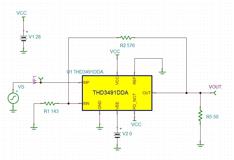

    I am implementing a basic non-inverting amplifier with THS3491. Supply is Vcc = 30V and Vss = 0V.
    I dont need a maximum swing, so I did not include any bias to the amp.
    The input is a 0-3.3V pulse with varying pulsewidth.
    I would appreciate if you could help me
    Kind Regards
    Kerem

  • Hello Kerem,
    The major issue here is the input and output limitations of the THS3491. Your input should be at least 4.1V away from either supply, so an input of 0V-3.3V is entirely outside of the usable input range. Your output has a headroom of at least 1.5V from either supply, this headroom becomes larger when a large output current is used. Because of these reasons, I would suggest biasing your circuit to midsupply as I have done in the attached TINA circuit below.
    This circuit will give you a 28V pulse with no load or a 75-ohm load to midsupply. However by referencing your load to GND, your output current and therefore the output headroom will increase and you will not be able to reach your desired 28V pulse.

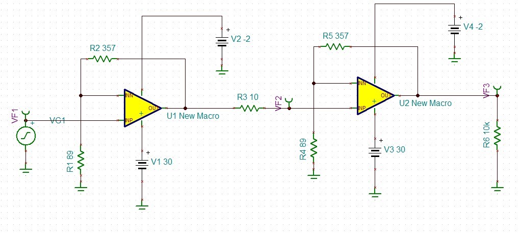

    Is that correct? Or could I use THS3062 or THS3095 instead? with a negative supply of -2V the simulations results look good.
    So what would you recommend me with my application. I checked the fastest VFA and found LM7171. Did couple of simulations looks promising.
    For single supply operation, I do not have to supply an bias. GBW product would be a problem when operating saturated, but for this I shall try cascaded amplification to have higher bandwidth. Also the output might not drop down to 0V, for this I could supply a small negative voltage.
    Thank you again for your help. It would be great if you could also comment on these points too.

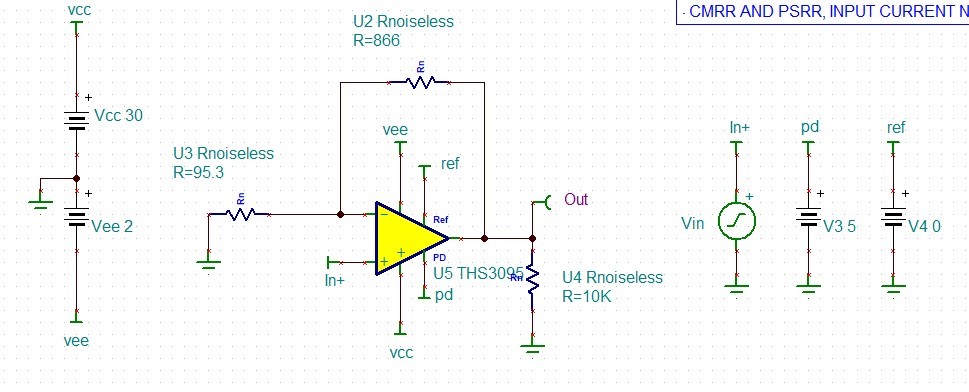

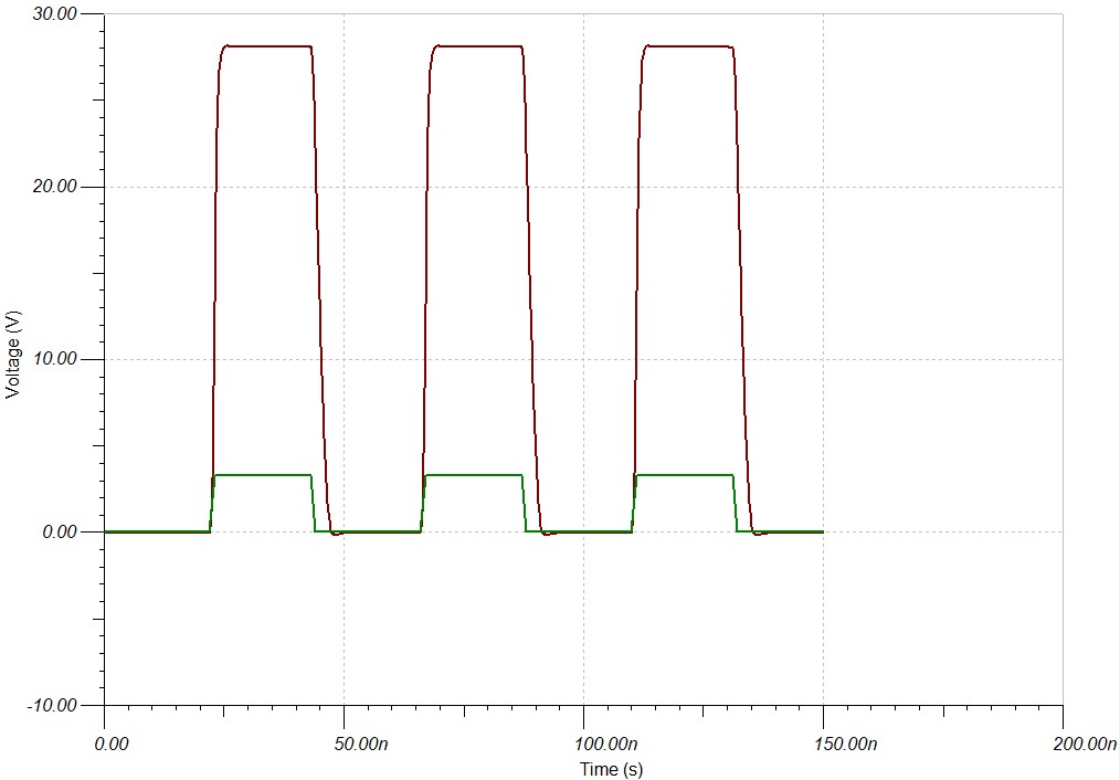

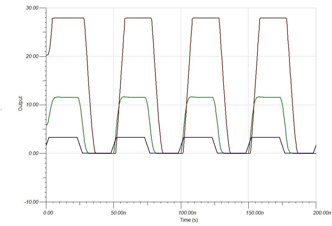

    I attach the circuit and the simulations of the parts.
    I would appreciate if you could comment of these circuits.
    Kind Regards,
    KeremLM7171_Sim.TSC  THS3095.tsc  THS3062.TSC
  • Hi Kerem,
    when driving a coax cable at least mount a series termination resistor at the output of OPAmp.
    And don't violate the common mode input voltage range of OPAmp!
    Kai
