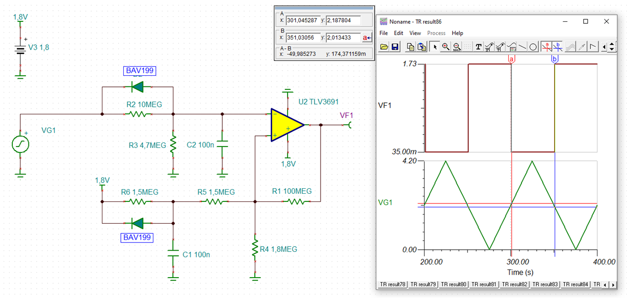

We are using TLV3691 Comparator as a Schmitt trigger circuit.
We designed schmitt trigger in inverting configuration. we gave input voltage to inverting terminal of comparator. Both the input and supply voltage of the comparator are from super capacitor. Please Refer the Schmatic PDF.
Schmitt trigger is working only when supply voltage Initialised first and then the input voltage given next to the comparator.
When the input voltage given first then the supply voltage Initialised - it is not working.
Is there any compesation circuit can be suggested to over come this? Or any other Circuit component can be used ?
schmitt trigger using TLV3691.PDF
