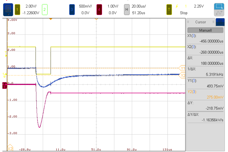

According to the formula in the datasheet I should get a voltage of 16.7mV at the end of the integration phase. However the output goes much higher (approximately 0.5V) and the integration curve looks weird (see attached oscilloscope screenshot).
I continuosly measured the voltage at the integrator’s input and this rises up to 0.5V, which is not desired – as I understood from the datasheet.
Color code of the signals on the screenshot:
Yellow: Hold signal
Purple: Output voltage, Integrator A
Blue: Input voltage (Sw In A)

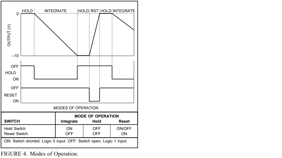

    Your schematic seems to be ok. However, I think that you do not have the correct timing sequences shown in figure 9 of the datasheet. Also see Modes of Operation in Figure 4 of the datasheet. Make sure that you have the required reset time to discharge the 100pF, which it requires 5usec minimum, see p.6 of the datasheet.
    Channel Select, Reset and Integrator output sequences have to be inside of Hold period, then the 100pF capacitor starts to integrate for 16.7usec (in your case) on the falling edge of fs clock frequency. I believe that the output voltage should be in saw tooth pattern (operated in the linear part of the capacitor charging curve).

    I do not use the Select channel at all. And as I see the Reset and Hold signals correspond to the timing diagramm on Fig.9. My Reset Signal was already longer than 5usec, but I made it even longer now. Please check my attached oscilloscope screenshot. Input current is 0.4uA now, Integration period is still 16.7usec and I use the internal capacitor of 100pF. My output voltage shold be -66.8mV. But I get -6.7V.
    Any idea what could be wrong in my configuration?
    yellow: Hold
    green: Reset
    purple: Integrator output
    blue: Integrator input, SW IN
    Thanks.

    Please follow Figure 4 modes of operation:
    During integration, Hold Switch is On (logic 0), Reset is Off (logic 1)
    During Hold states, both Hold and Reset switch are off (logic 1)
    During Reset period, Reset is On (logic 0) and Hold switch will On then Off.

  • Hi Raymond,
    the problem is, I do not have any fs signal. In the datasheet the fs signal is a digital current input. But in my configuration I have a DC current input. This is why I thought, that I can determine the Integrator output through the formula from page 10.
    You wrote that my fs signal goes high, when reset occures. But the purple signal is the Integrator output, not the fs. Please see my legend to the screenshot signals at the end of my last reply.
    The output returns to 0 if reset occurs (see screenshot), as expected. And there are two Hold periods before and after my reset (see screenshot).

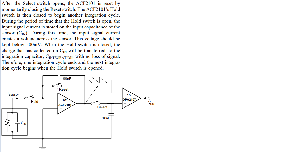

    For continuous current integration, hold should be small percentage of integration timing. In Figure 10, Cin is charging while Hold switch Open. When Hold switch is closed, the charge in Cin will transfer the charge to integrating capacitor.
    You have a constant 0.4uA current source, when Hold switch is Open (250usec or longer), the IC is not integrating the current, that is why I am suggesting the alternative.
    If you have an extra pin at your MCU, I will suggest to add Select signal to ACF2101. You may be able to integrate the current at lower fs frequency with 100pF.

    I think that you got it. Your integration time is only 500usec, not 1msec. Delta_V=0.3us*500us/100pF=1.5V.
    I think that you can go with longer period or lower frequency. you will have plenty time to do other conversion. Do you have sensor at the input of the integrator? I thought that you had a constant DC current source.
    Regarding Cin is kept below 0.5V, I believe that it is for linearity reasons. You want to keep in a linear part of capacitor charging curve in Cin. How much errors can you tolerate from the setup? Please let us know.

  • Hi I Sandor,
    This is the reason why Cin has to be kept below 0.5V. However, you can find a way to reset the integrator, if you find the error is unacceptable prior to integration.
