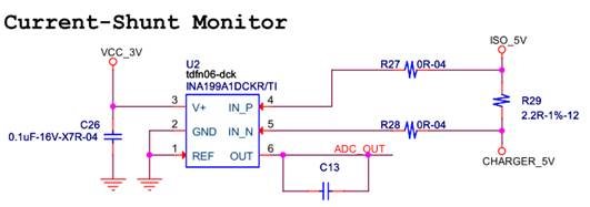

1. My customer use INA199 in detect charging current.
Recently, during trial production, it is found that the IN + / IN- input has low impedance to the ground after charging.
Could you please check the schematic to see if anywhere needed to be modified?
ISO_5V = USB Adapter 5V/1A
CHARGER_5V = load current<90mA
2. If I use a USB charger and the load current is less than 80mA, do I need to add protection to the input terminal?

  • Hi Jamie,
    The partial schematic looks fine.
    Low impedance to ground implies that the input pins are damaged, the first place I would look into is transient events. The datasheet devotes a section talking about this issue and potential pitfalls of A version devices in certain applications. Please refer to section 8.4.5 “Improving Transient Robustness”.
    Particularly this paragraph:
    It is recommend using B or C versions for this customer’s configuration. The issue should go away if the nature of the transients is similar to described, and no extra protection should be required.
