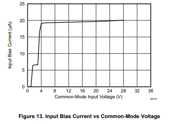

What's the best accuracy i can achieve to monitor current?
I have a 30uA power rail i want to monitor.
  • Hello Lior,
    Thanks for considering to use Texas Instruments.  If 30 uA is your max expected current and you are considering the INA231, you will be sinking more current than you intended because of the input bias of the current monitor.  According to the Electrical characteristics table, the INA231 typically pulls 10uA at a 12V common mode.  But as you can see from the device used to generate the figure below, It could be higher than that.  If you do a low side measurement, then the input bias current might be more reasonable for your application.  Since there are multiple error sources involved in determining accuracy or error, I would need to know your operating conditions (supply, common mode, temperature, and shunt value) to have a closer approximation of the error you might see.  But from input bias alone, I would say your error is: (input bias)/(ideal load current)*100.  This error will get significantly worse with the lower end of your current range.  I recommend you consider the INA190, an analog output device with an input bias of 3nA.
