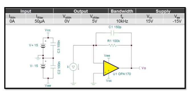

Good day,
I am currently working on an visual light communications project for my thesis. The TL084 is being used to amplify the signal on the photodiode end. The target bandwidth is 6Mbps, so we are trying to see if the reciever circuit and properly function in the MHz range. However, the current results shows distortion in the wave form on the receiver end at frequencies as low as 1 kHz. I would like to know if the issue is the way that the amplifier.

  • Hello Yu Jie Wang,
    There is no DC bias (no DC operating point) on the non inverting input. The noninverting input should be between VCC- +4V and VCC+ - 4V.
    The feedback load is very heavy. Try 10k and 1k resistors instead.
    TL074 is a high voltage amplifier that is not rail to rail input. What is/are the supply voltage(s)?
  • Hi Yu,
    there are several mistakes in your circuit. You must provide a current path for the input bias current of TL084 to signal ground. Also, the zener diode at the output of TL084 can introduce a considerable load capacitance which can cause a stability issue. Then, you probably power the TL084 with a single supply voltage allthough the TL084 is no rail-to-rail OPAmp and has a very limited common mode input voltage range? More, the TL084 is not fast enough for a datarate of 6Mbps.
    I would strongly recommend to proceed with a TIA (transimpedance amplifier). This is the topology usually chosen when amplifying the signal of a photodiode.
    Kai
  • Thank you for the prompt reply, I have swapped to a transimpedance set up. My Capacitor value is 16 pF as i am trying to first hit the milestone of 100 kHz. My current bottle neck is now on the transmitter side as our Raspberry Pi that we use as a digital signal that drives an LED circuit is only outputting at 6kHz.
  • Vccs were set at +- 15 V. If I increase the resistor values, would I not be more prone to increased thermal noise ?
  • Yu Jie Wang,
    Yes, resistors have noise that increases resistance. However noise is the least of the problems so far.  Speed will be the biggest hurdle. Many photodiode are not very fast. To get a 6 MHz square wave requires op amp bandwidth far greater than 6 MHz. OPA170 is the slowest in that family, OPA172 is 10 times faster, 10MHz  but not fast enough.
    It may be useful to pick a great photodiode first. It's data sheet might even recommend a receiver circuit.
