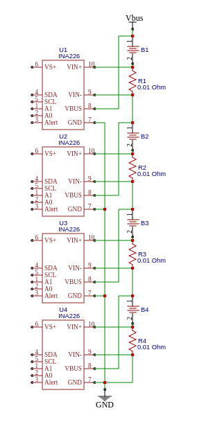

I have some confusion with values of INA226 shunt register which I've got on my test schema (can see at e2e.ti.com/.../873715).
I have schema with four loads and INA226 connected by series.
General supply input is about 5 V.
I used four resistors by 22 Ohm connected serially as load and interleaved with shunt inputs of four INA226.
Expected current in chain by Ohm law is about 5V/(22Ohm*4)=0.056A. I used 0.01 Ohm shunt resistor so voltage on the shunt should be about 0.056A*0.01Ohm=560uV, which corresponds to value 224 (0x00e0) in shunt register. But I got cardinally different values, are about 500 (with some deviations for each INA226).
Where is my mistake?
And second question - why voltage values so much differs? I checked with digital multimeter - difference can reach tenth of volt.

  • Hi
    Peter, thank you for reply!
    I attached my schema at end of this message. For testing purpose I temporary use resistors as load instead of batteries.
    I have measured current in my schema with two different multimeters and one oldschool analogue tester (which with arrow). All three devices show value in range 52-58 mA with little spread.
    Also I changed shunt resistors to new in two modules which show current with most deviation from average value but without any valuable result.
    I plan to grab i2c conversation with logic analizer, but I think this haven't big chance to succes.
    I'm stuck and slightly confused about what else I can check...
    So I'll glad to any help)
    PS. I'm beginning to suspect that IC in modules are contrafact replica, is it possible? Modules bought on one wide famous chinese trading platform...

    I increased current via load as that is enough to measure shunt voltage drop with my DMM and found that shunt resistor (or input chain) has significant deviation of resistance, which is about 34% from nominal. So when I corrected calibration value I've got value is very close to expectation.
    Sorry, I stealed your time. Thank you again!
