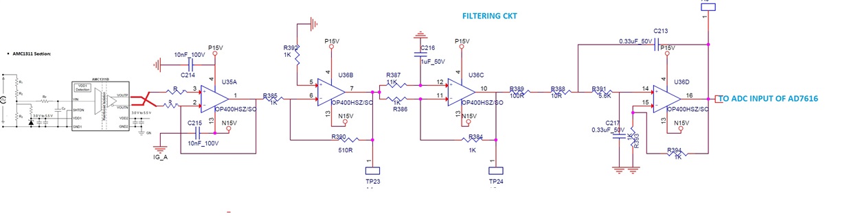

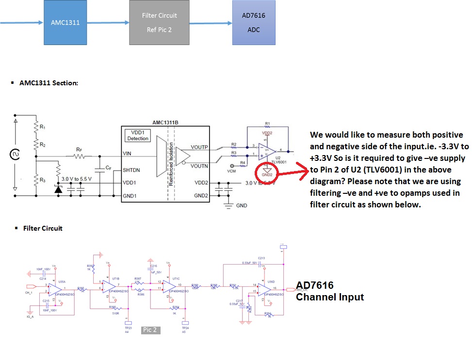

We are planning to use AMC1311B for AC Voltage measurement. Schematic is as given beloe
Question:
1) We would like to measure both positive and negative side of the input.ie. -3.3V to +3.3V So is it required to give –ve supply to Pin 2 of U2 (TLV6001) in the above diagram? Please note that we are using filtering –ve and +ve to opamps used in filter circuit as shown below.
Or shall I modify as given below...
Will the above Circtuit works ?
Requesting for quick reply.
  • Hi Haranath,
    TLV6001 has a recommended power-supply voltage range of 1.8V to 5.5V or +/-0.9V to +/-2.75V. So the device won't work as desired when using a power supply of +/-3.3V. And yes, you need to use a dual-supply if you would like to measure below ground.
    Based on your application, looks like you will need to use a high-voltage part. Can you provide me your desired input and output for the op amp, based on that I can recommend a part that will work for you along with a recommended circuit configuration.
    For the filtering circuit, looks like you're using OP400, this is an analog part. Can you also elaborate on what's the purpose of the filtering circuit?
