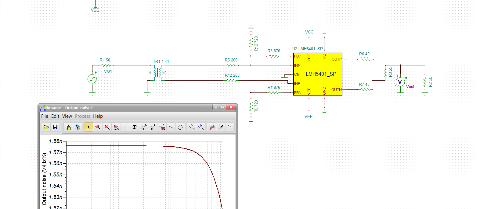

I am using the LMH5401-SP in a differential to single ended configuration. The measured noise figure was much greater than predicted from the noise models. The issue appears to be due to common mode output noise. What is the common mode output noise supposed to be? With the circuit below I measured 6.4nV/sqrt(Hz) of common mode output noise (doubley terminated measurement into 50 ohms). TINA predicts ~1.6nV/sqrt(Hz).

    Good morning! The TINA file is attached. The noise was measured using an LNA + spectrum analyzer with an overall noise figure of 1dB. With a 15dB ENR noise diode connected through a transformer to the input resulted in less then a 0.1dB increase in output noise when the common mode noise was measured using the TINA circuit which indicated that the resistors are well matched around the circuit. The common mode voltage is connected to a ground plane, the circuit is powered off +/-2.5VDC. Both supplies are filtered with LDO's followed by pi filter networks. The capacitors used in those networks are the feed through type and placed adjacent to all 4 power pins and connected directly to the ground plane. We tested a similar circuit on the LMH5401 eval board and found the same result; a high noise figure when measured single ended, and the expected noise figure when measured differentially.

  • Very nice summary Shawn, Your schematic looks ok except I think the impedance match might be off - that looks to be a 1:1.41 turns or 1:2 ohms ratio which would suggest two 100ohm inputs for match - differential input impedance is just the sum of the two Rg's.Those R's to ground only increase the Noise gain hurting NF.

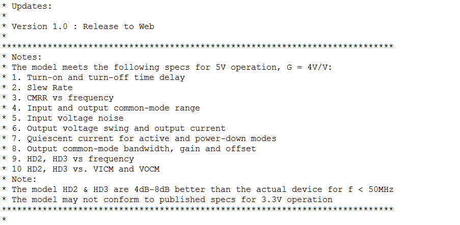

    I ran your sim for output spot noise, looks way too low for what I know is inside there - reflected back up through the match, this is about 3.2nV CM noise at internal output pins. I cannot find any spec or plot in the datasheet, so not sure what the modeling guy was trying to match to. What you measure for CM noise is likely more correct and it looks like you are doing it correctly.
    The model header does not claim CM noise modelled,

    Thanks for the link to the article. When this circuit is used in the real system the output comes from a DAC which has internal 50 ohm pullups to +3.3V. The circuit has to be DC coupled to the DAC and have an output common mode voltage of 0V. Dropping the input resistors to 50 ohms would have pulled the DAC outside it's output compliance range. So a trade off was made between the impedance match and common mode compliance range.

    So obviously your last comments mix things up a lot, if you need to be DC coupled, why is the balun in there? Perhaps the CM on the DAC needs DC consideration on the DAC pins, but the signal itself is AC coupled through the balun?
  • Hi Michael,
    I am in Baltimore. Sorry to make this more confusing than it needs to be. We built the board without the $17,000.00 FPGA which contains the DAC to verify everything else works as expected. The transformer was added to the board verify the op-amp circuit works as expected.

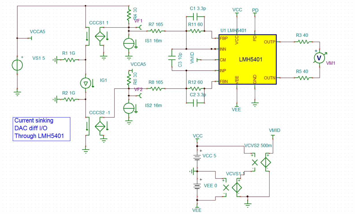

  • Also Shawn, I found an earlier DC coupled current sinking DAC to diff out with the LMH5401 TINA file - not set up how you want it but a good start (single 5V supply design using an E2V DAC). You can adjust this to your needs. The signal is that IG1 generating complementary inputs from a DC centerpoint with 1/2 the tail currents on each side - running a slow DC square wave will show you where the input pins a moving.
    Current sinking DAC through LMH5401.TSC

    It would be nice if TI would update the TINA model and/or the data sheet to indicate the common mode noise. Thanks for the links to the article, I was able to see the figures. I was unable to open the TINA file, if you could send me a picture of the schematic that would be great.
    Shawn
  • No doubt better data in the datasheet and model would be useful, this is only one of several misses in the FDA models on CM noise.
    I saved and sent that file as a V9 version as you had sent, should have opened for you, but in the meantime, here is a picture,
  • Hi Michael,
    Thanks for sending the picture! This is essentially the same circuit I currently have, the only difference is that I added a pull down resistor from INN to VEE and another pull down resistor form INP to VEE so that I can use to trim the DC offsets and adjust the input common mode.
    Shawn
  • You bet Shawn,
    Well then you are on the right track, keep in mind those pulldown resistor increase the noise gain slightly impairing output noise. Still not sure why output CM noise should be of much concern? Normally not, but in some audio work I was doing the very high 1/f noise down at 2Hz can become problematic once feedback ratio mismatch is considered.

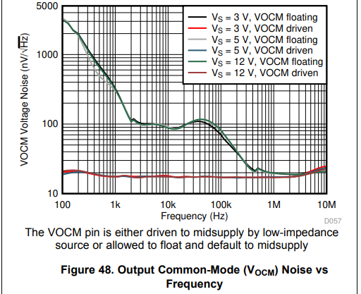

  • Well yes Shawn,
    Anything following this stage will have a CMRR that will try to reject the CM noise with mixed success (over frequency) and that can be a concern.
    1. Your balancing resistors might give a nominal diff output zeroing, but not over temp unless this is a cal loop.
    2. output CM 1/f noise is yet another poorly modelled (described) element.
    I was recently mystified comparing the "measured" output CM for the MCP6D11 FDA vs the finally released THS4561 - the driven input CM noise plot is pretty remarkable (suspect) on the latter,
    MCP6D11 CM noise plot - at 2Hz, this could get a little scary -
    And then the THS4561 where the driven input noise looks almost chopper like in flatness to low F - interesting,
