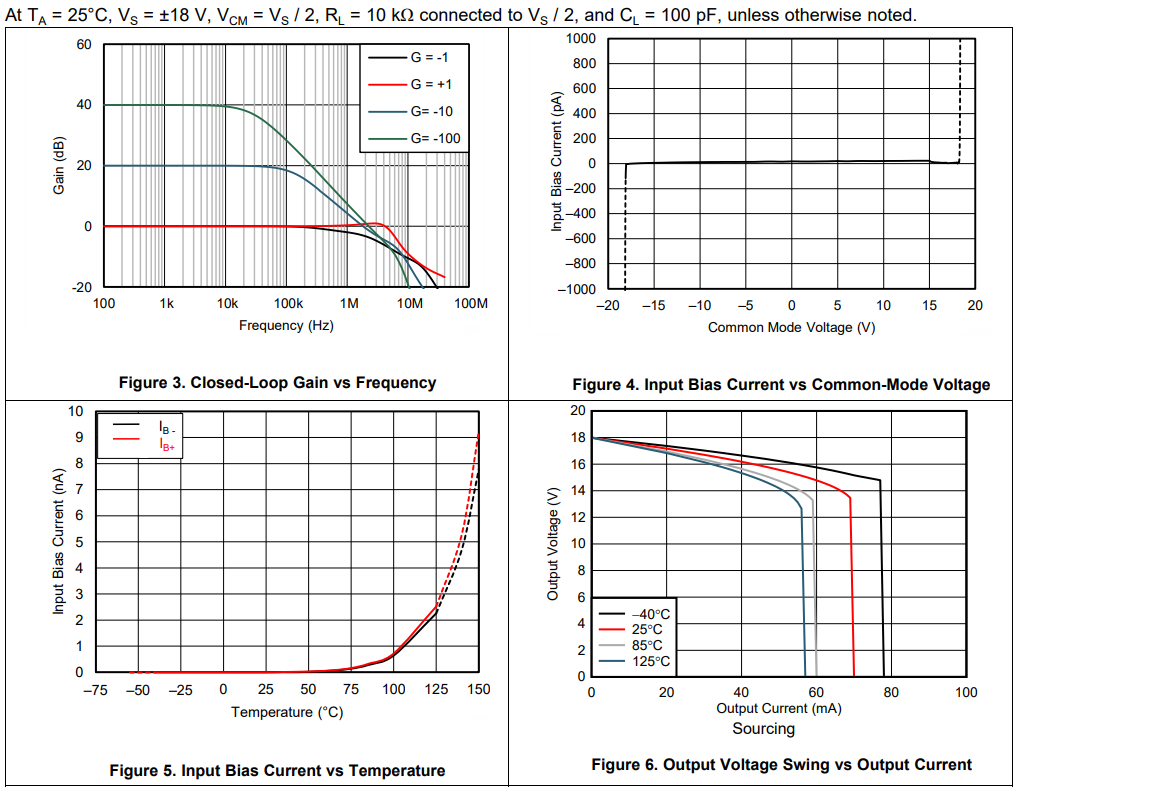

The OPA196 datasheet lists the input bias current maximum at 20pA. Does this 20pA maximum apply over the entire common mode input voltage ranges as depicted in figure 4 ?
  • It's difficult to interpret what the Ib vs. CM voltage variation is given the y-axis scaling (±1nA) the figure 4.
  • Also...can you confirm that the figure 5 y-axis units are in fact "nA" and not "pA". Same issue with this graph...hard to interpret the spec from -50°C to 75°C given the scaling used in the graph.
Thanks for the help.
  • Hi ,
    In OPA196 datasheet, the input bias current and common voltage plots are presented in Figure 4 and 5, see the image below.
    Question:
    The vertical scale in Figure 5 is in nA scale. It is difficult to present such wide temperature range in a linear plot. I will request for a better graph from our characterization team per your temperature range from -50°C to 75°C.
    Raymond

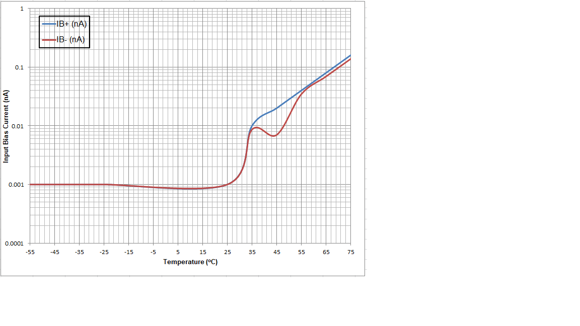

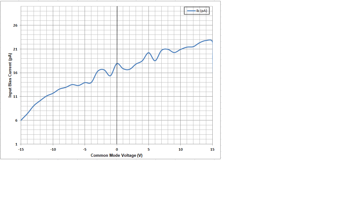

  • Thanks for the response. Yes, please provide any other characterization graphs you may have.
  • Hi ,
    Per your request, OPA196 sample's Input Bias Current vs. Common-Mode Voltage and Temperature Data:
    OPA196 Op Amp' s Input Bias Current vs. Common-Mode Voltage for Figure 4 with finer vertical scale is shown below.
    OPA196 Op Amp's Input Bias Current vs. Temperature for Figure 5 with finer vertical scale is shown below.
