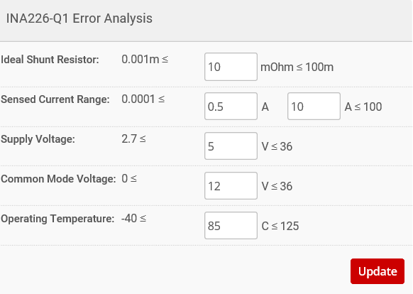

Can customer use INA226 at following condition ?
Supply Voltage:12V
Shunt resister:25uOhms
They would like to measure Current up to 30,000A.
We found Sensed current range in below error analysis is up to 100A.
Please give us your comment.
    The INA226 shunt voltage measurement range is ±82mV, which translates to 3.28KA peak current with a 25uΩ shunt.
    For error simulation, what matters is shunt voltage which equals to current X resistance. The absolute values of current or resistance don’t matter. Therefore we can scale them proportionally to fit into the calculator.
    The above condition is equivalent to Shunt=2.5mΩ and current=0 to 32.8A. All you need to do is plugging these numbers into the calculator, just remember to multiply X-axis by 100 to reflect the actual current magnitude.
    Regards, Guang
