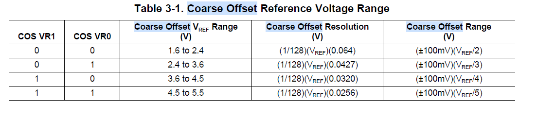

(1) At table 7-31;
For example, VREF=3.3V and COS VR[1:0]="01"; Resolution of the Coarse offset is
(1/128)(VREF)(0.0427)=(1/128)*3.3V*0.0427=1.1mV
Is it correct?
And then, is the range correct below? (Is VREF integer [V]?)
(±100mV)(VREF/3)=±100mV*3.3/3=±110mV
(2) At table 7-31; Can we set the register COS VR[1:0] other than '01' if VREF=3.3V?
If we can: Is there correct the resolution and the range below (VREF=3.3V and COS VR[1:0]='11' setting)?
 - Resolution: (1/128)(VREF)(0.0256)=(1/128)*3.3V*0.0256=0.66mV
 - Range: (±100mV)(VREF/5)=±100mV*(3.3/5)=66mV
(3) At table 7-30;
For example, VREF=3.3V and COS VR[1:0]="01" setting, we change a value of the Coarse Offset and a formula of the Coarse Offset Program in the table to the resolution and the range the formula at (1) question. Is it correct?
KT
  • HI KT,
    You are correct, if using the VREF=3.3V COS VR1='0' and COS VR0='1' offset resolution is 1.1mV, and the range is +/-110mV
    Per the PGA308 User Guide, the internal circuitry for the Coarse Offset DAC  is optimized, and specified/characterized for a given reference input range.
    Please see Table 3-1 with the recommended/optimal COS VR1 and COS VR0 settings for a given reference input range are as shown on table 3-1.
    If you are using the 3.3V reference input, the correct setting has to be selected with COS VR1='0' and COS VR0='1' as shown on the table below.  (Corrected typographical error 2-10-2020 in Red)
    The User guide recommends to use the COS VR1 and COS VR0 settings per table 3-1, and advises to select the settings to the closest voltage range in the table, so it is not recommended to use a different register setting for VREF=3.3V.
