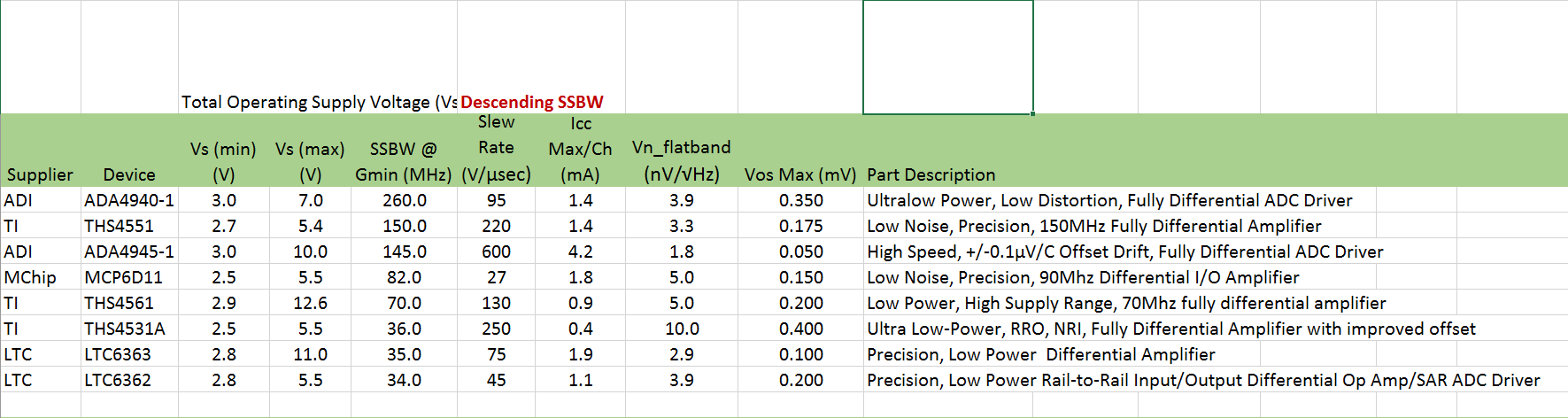

  • Oh and Shinu, I was looking back over some AudioExpress articles and found a recent parametric table pertinent to your question - that is here, these are very low HD more DC precision oriented choices in descending gain of 1 SSBW. What really jumps out is the much higher ADA4945 quiescent current - very good part, but not nearly as power efficient as the others.
    And note the gain of 1 SSBW is an easy metric, but kind of deceptive from a gain bandwidth product perspective - for instance, the ADA4940 and THS4551 are almost identical gain bandwidth product, but the ADA4940 is allowed to peak more to get the closed loop gain of 1 bandwidth extension.
