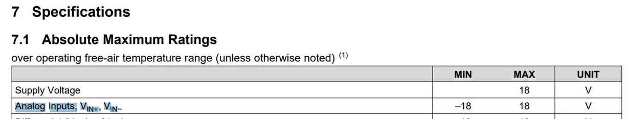

Part Number: INA193
"Analog Inputs, VIN+, VIN−" is specified on the datasheet.
What does it mean?
Kuramochi
Part Number: INA193
What does it mean?
Kuramochi
Hello Kuramochi-san,
This is the same as differential input voltage Vsense (VIN+) - (VIN-) as shown in the line below.
Ian Williams
Applications Manager
Current Sensing
