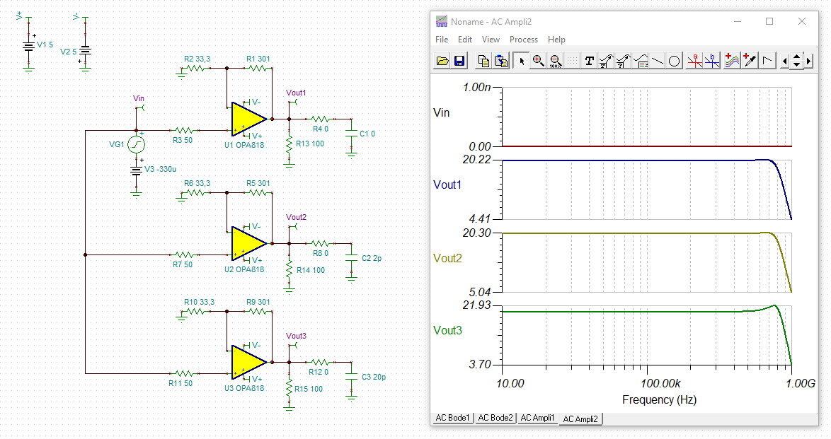

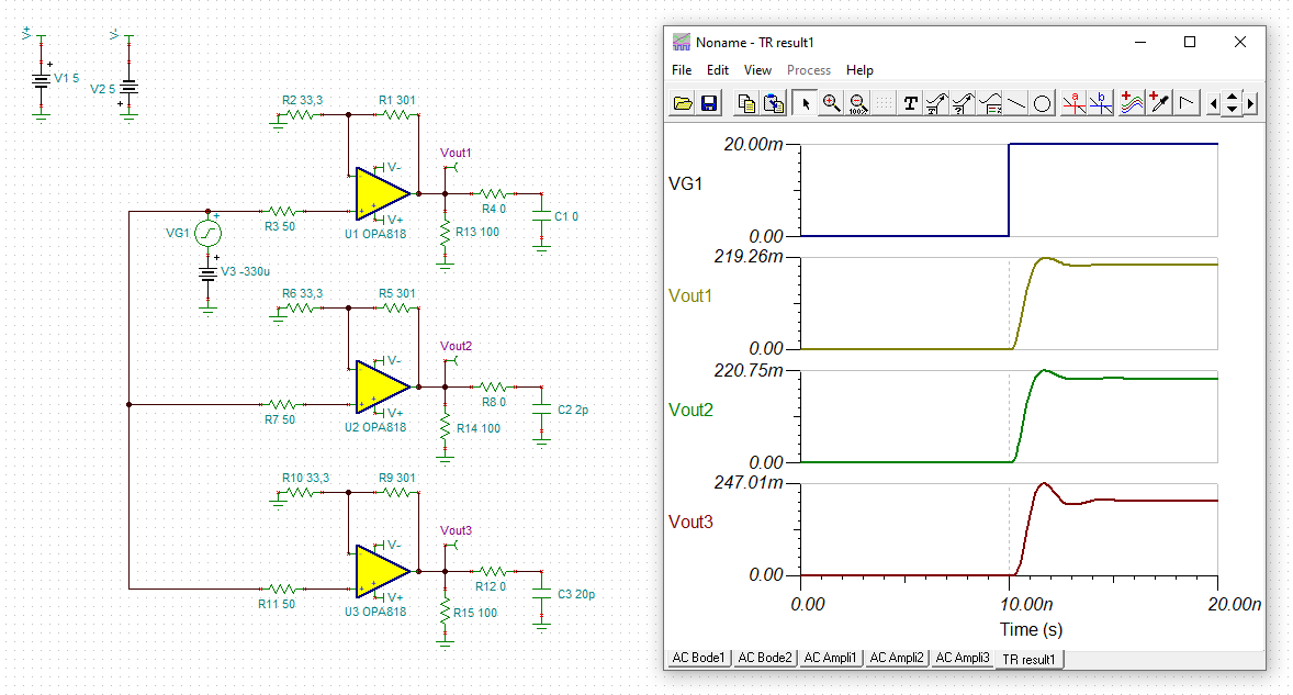

I have another question relating to my circuit in TINA using the OPA818 in the previously attached file - OPA818test.tsc.
For some bizarre reason it will now not run an AC analysis - it just states, 'Only one input is allowed!'. Clearly there is only one input source and it did the plot previously, so what is wrong?
Also it will not perform a noise analysis for the same reason stated above!
But it will easily perform a Transient Analysis!
Could someone please assist?!
Thanks.
Peter

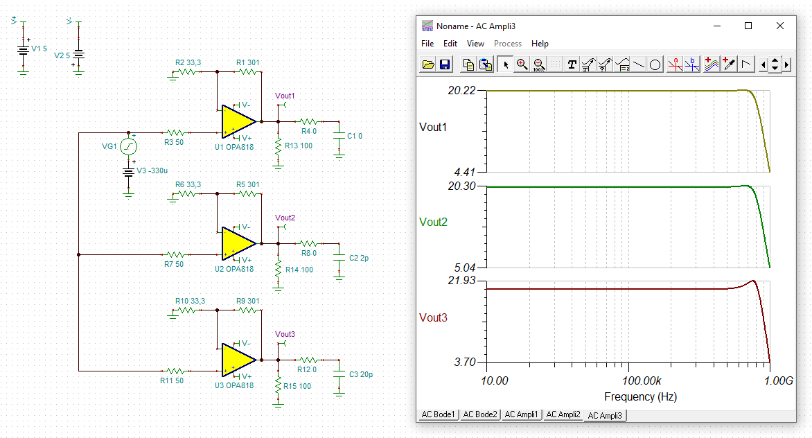

  • Hi Peter,
    you have configured "Vin" as "input" allthough there is already an input source, "VG1". Remove "Vin", add again a "voltage pin" and name it "Vin" again, but don't change the "IO state".
    peter_opa818.TSC
    Or just remove "Vin" at all. There is no need for it:
    peter_opa818_1.TSC
    A last hint: Be careful when drawing "wires" in TINA-TI.
    Kai

  • Hi Kai,
    Thanks so much for your prompt response and answer!
    I have only very recently started using this sim and still finding my way around it.
    I can sort of see why there is a conflict but my understanding was that Vin is just a label. Now I see it can be configured as an 'Input' or 'none'.
    This just seems to generate confusion! If it is configured as an input what is it actually inputting? In other words if the program looks at it as similar to VG1 which is a source, what is it sourcing when configured as an 'Input'?!!
    My understanding is that Vin is required for TINA to look at the input, for graphical purposes, but it seems it isn't required - as you indicated 'there is no need for it'.
    Not being difficult but trying to understand the use of this 'Vin' label or whatever it is!
    Peter
  • Hi Peter,
    working with a simulator like TINA-TI or LTSpice often turns into a trial and error approach. I cannot answer your question, it was just a wild guess that "Vin" might have been configured as an input...
    I like TINA-TI very much because you can do your job very quickly and with reasonable results. But sometimes it just behaves weird and doesn't tell the truth :-)
    Running a TI's TINA-TI reference design has the considerable advantage that TI has already confirmed that the simu works. Also, TI has often modified and optimized the "analysis parameters" which can be very helpful.
    Kai
