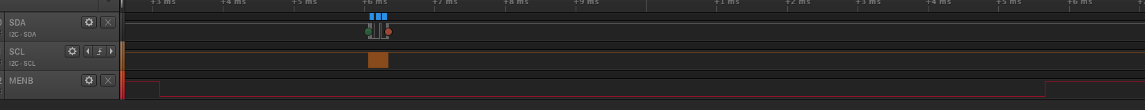

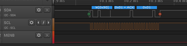

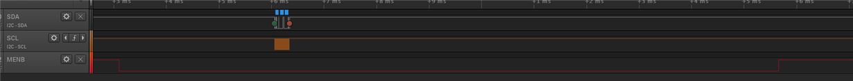

    See here below for what this looks like from logic capture (click on them to see larger)-
    Overall:
    Zooms on first I2C comms
    over I2C (on address 0x48 (7bit), 0x90 (8bit))
    do have you similar logic captures to show where it fails for you?

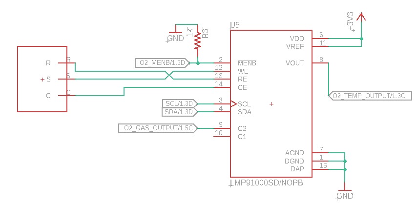

  • Dear user6246305 -
    Just to be clear, you are using the MENB pin similar to a chip select, correct? (not just grounding it)
    I am assuming the mikroc is a PIC MCU device, correct? Perhaps sending over your schematic and the logic capture of what is actually occurring on your I2C lines + MENB behavior would be helpful to us.
  • Just to be clear, you are using the MENB pin similar to a chip select, correct? (not just grounding it)
    Note : R3 = 1K
    Yes,,
  • thanks -
    so you have MENB always pulled down and the MCU is keeping GPIO high to disable comms to the part? I think I would instead have pulled it high and had MCU go low - may want to look at the power savings difference between those if it matters to you - this way looks like 3.3mA system current draw for periods of time you could otherwise be low on MCU GPIO.
    Do you have pull-up resistors on the I2C lines?
