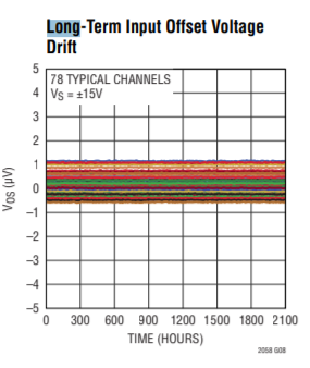

  • I did also stumble across another measured data plot over 88 days in the LTC2058 - again, basically flat at initial value,
