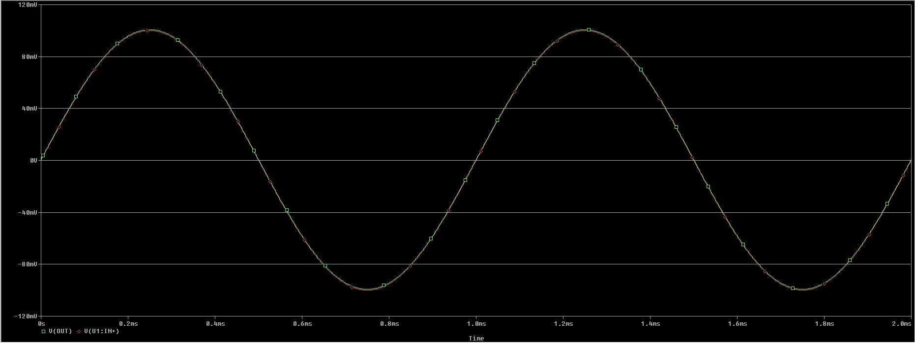

TLV316: I am facing the problem in Pspice model.
Part Number: TLV316
Other Parts Discussed in Thread: TINA-TI
HI,
I am facing problem in spice model,
Its getting stuck at 52% and not moving further.
If i stop the simulation i am getting the error as Pspice_errors.docx

  • Hi Naresh,
    I'm sorry that you're having trouble using Cadence - PSpice. The model was made using Pspice version 17.2. I believe that you're using version 9.x. The error is because Pspice is not very friendly in terms of backward compatibility. I was able to successfully simulate the file you shared in Version 17.2, I've shared the screenshot below.
    One option is for you to upgrade to a newer Pspice version. If that's not an option, please consider using TINA-TI (it's a free simulation software).
    I've also went ahead and built the same circuit for you in TINA-TI. Buffer_TLV316.TSC
    Let us know if you need any further assistance.
