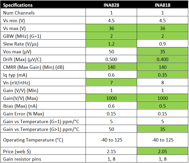

  • Hi Kenji,
    Thank you for your post. I can help you.
    You're right, the way the data is displayed for the INA828 and INA818 is different. The INA828 is referenced to +25°C. At +25°C, the Gain Error y-axis value is 0ppm. However, for the INA818, this is not referenced to +25°C. The Gain Error value seen at +25°C is approximately 47ppm. If you reference all values to this (add 47ppm to each data-point), you should receive a graph similar to that shown in INA828 datasheet.
    We need to make note to make sure these graphs are consistently displayed. Thank you for bringing this up to our attention.
    -Tamara

    I again compared Gain Error vs Temperature (G = 1).
    Comparing the graphs of INA828, INA821 and INA818, INA828 has overwhelmingly better performance.
    [INA828]
     ΔT = 125 ° C-(-40 ° C) = 165 ° C  Gain drift = {0.7-(-1.7)} / 165 ℃ = 0.015ppm / ℃
    [INA821]
     ΔT = 125 ° C-(-40 ° C) = 165 ° C  Gain drift = {84-(-28)} / 165 ℃ = 0.68ppm / ℃
    [INA818]
     ΔT = 125 ℃-(-40 ℃) = 165 ℃   Gain drift = {-40-(-67)} / 165 ℃ = 0.164ppm / ℃
    My customer evaluated INA828 and found that it was 20ppm / ℃ at Ta = 50~80℃.
    I think the results of the INA828 data sheet are too good. Can you provide some actual ability data?
    Also, I think INA818 is a newer device than INA828. What are the features of INA818?
    What should I use for the difference? I would like to know the effective difference.
    Finally, INA821 is listed as "Average of 294 units".
    Figure 30. Is Gain Error vs Temperature an average of 294 units?
    Or is it just one average representative sample?

  • Hi Kenji,
    I understand and I appreciate your patience.
    • How did the customer measure the INA828 gain error drift? Please share the schematic and test procedure. We especially need to know the following:
      • What are the input sources? We recommend DP8200 DC power supplies.
      • What kind of volt meter are you using? We recommend HP3458 DMM.
      • How is the DMM connected? Output to ground? Output to input?
      • What is the reference voltage?
      • What is the common mode voltage?
      • What voltage is seen at each input?
      • What are the supply voltages?
      • All schematic details and test procedure will help us determine whether or not the customer is correctly measuring this.
    • Figure 30 of the INA821 datasheet is an average of 294 units. It says it on the curve.
    • Here is a spec-spec comparison of the INA818 vs the INA828
