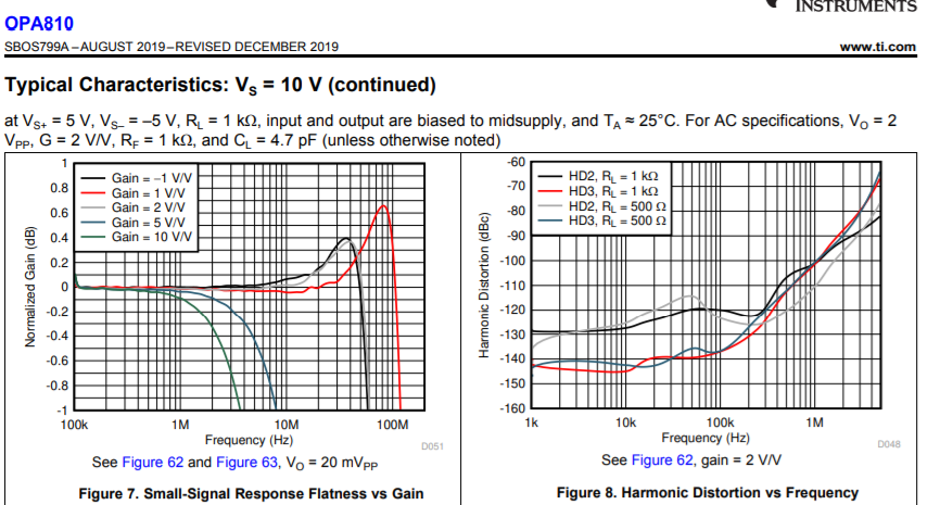

    1. That -80dBc into 100ohm load +/-4V output (+/-40mA) through 150kHz is the tough one. Need to start out with quite a bit of loop gain at that frequency to have any hope, which means a lot of GBP.
    you might look at the OPA810 at gain of 2 on +/-5V supplies. Being RRout +/-4V output should be ok. Plenty of output current and slew rate margin. (you said amplifier output of +/-4V is that at the output pin assuming the backmatch loss. If you actually need +/-4V at the matched load, then the +/-8V output will need maybe +/-10V supplies and might push the output current available too hard).
    2. Being JFET input, very low input noise current and bias curent. AC coupling will be fine.
    There does not appear to be a 100ohm HD plot, but the 500ohm curve here says you have 40dB degradation range to still hit -80dBc decreasing the load to 100ohm and increase the swing from 2Vpp. MIght make it at 150kHz, Actually the curve does not quote a Vpp swing (that is a mistake, but often it is 2Vpp for this kind of curve).

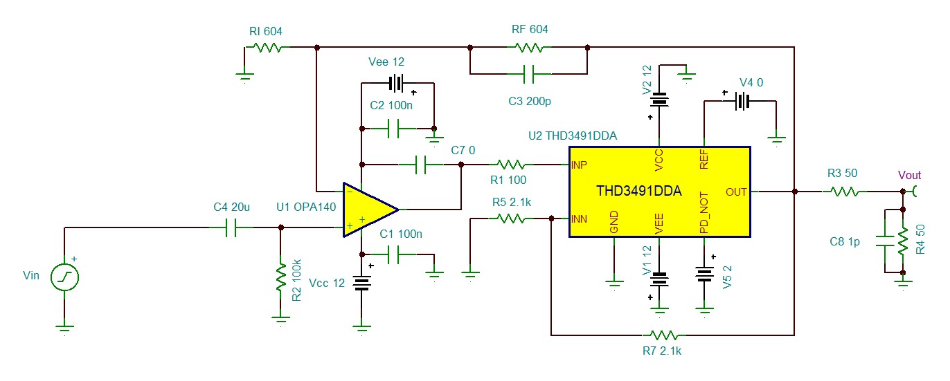

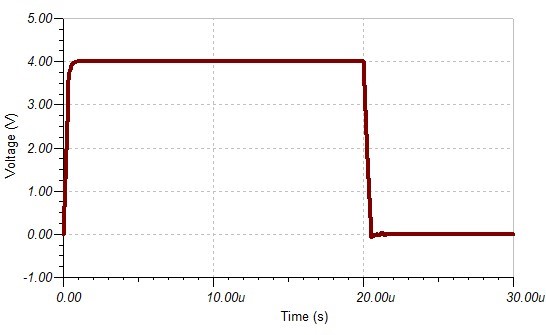

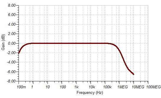

  • Dear Michael,
    please find a tentative schematic of an embedded amplifier with OPA140 and THS9134:
    the current feedback has been set to a G=2 with the suggested Rf and Rg.
    This is the AC transfer function:
    here is the noise and transient:
    Could you please suggest any modification/improvement to the circuit ?
    Thank you so much for your time.
    Alberto

  • Hey Alberto,
    Looks pretty good to me, what would you like to improve?
    To avoid motorboating, bring the supplies into the THS3491 1st then RC filter back to input stage supplies- also, to make sure there is DC bias point on power up, put a 10kohm resistor to ground on the THS3491 V+ input.

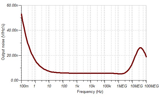

  • Dear Michael,
    thank you for your advices.
    Please, have a look at the noise simulation. You can spot a peak at high freq, similar to the one shown by a TIA with a capacitive load.
    I do not understand the reason and the source. The circuit has a low pass filter 'built-in' thanks to the capacitor across the feedback resistor.
    However, the gain noise increases at high frequency.

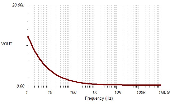

    Last issue: TINA-TI gives a THD of 65% ! Not 0.065%... not even 0.65%... I am doing something VERY wrong ?

  • Just for reference, this is the TINA-TI project:AC_OPA140_THS3491.TSC
  • Morning Alberto,
    Well whenever you do this kind of composite you are injecting a prop delay inside the loop - the next step would be to set up for a LG phase margin sim. But that noise peaking does not look too bad actually.
    As for distortion, let me assure you the requisite terms to accurately produce that data are not in the simulation macromodels - HD2 is not well simulated even in the full cadence design models.
    Your problem now is more simulation approach oriented - one trick is to make sure the time record starts as cosine at time zero not a sine - that gives an initial dv/dt of zero which improves the initial transient response that eventually gives you the HD terms. But that will still not give you a reliable answer - only the bench will in this case.
    Again, while these composites are kind of fun and interesting, if you can find a single op amp stage that will do what you want, the path to success is less fraught with hazard. I still think something like the OPA810 should merit some attention.
