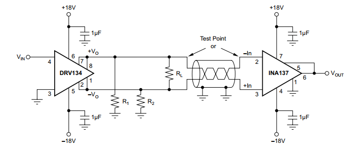

I want to implement an analog circuit like the Block Diagram below. Recommend reference Docs and opamp products.
(Differential-ended cable , flat cable , long distance ~50cm)

I asked about the connection between the single amplifier and the differential amplifier, because the experimental environment I use and the area of the equipment I develop are quite large.
The dsp and insulation solutions provided by ti are very good. But the industrial products I develop are often bulky. Typical examples include welding machines, small electric car chargers, and inverters.
Then the position of sensing voltage and current becomes very long. Often in the laboratory more than 50~cm.
In addition, since the environment is noisy, the sensor circuit itself is often used separately from the controller. If this is not used, high current or high voltage signal must be connected to the controller, which requires very difficult connection depending on the product.
And I use more than 8 channels of signal. In this case, many signal line cables are needed.
There may be a solution such as spi adc, but first, it is difficult to modify it to fit the dsp controller and new code must be developed. And since c2000 implements real time interrupt in ad port, it is preferable to read real time signal rather than controlling adc through spi communication.

Dear Kai
DRV134 seems to be an audio product, can it be used for industrial purposes?
Choi
Hello Choi,
There shouldn't be issues using the DRV134 in an industrial application, in fact "Industrial instrumentation" is listed as one of the applications on the datasheet. Another option for single-ended to differential conversion would be to use a fully differential amplifier.

Yes Choi,
What Hasan is maybe suggesting for these higher supply lower speed requirements is a part like the THS4131.
If you are swinging pretty high swings there, check your signal slew rate against the device slew rate.

The FDA using single Power supply, you've given me a lot of help. Is there 'a differential-ended to single-ended OPAMP circuit' that uses a single power supply if possible?
(i find another documents, Differential input to differential output, but don't find Differential to single output)
In fact, I didn't think 'a single to differential-ended opamp circuit' was configurable as a single Power supply.

Hello Choi,
In regards to differential to single-ended conversion, you may want to use an instrumentation amplifier:

Hi Choi,
is you cable 50cm long or 50m?
In an industrial ambient I would think about adding protection circuitry against ESD, BURST and SURGE. This might be needed to comply with the CE standards.
