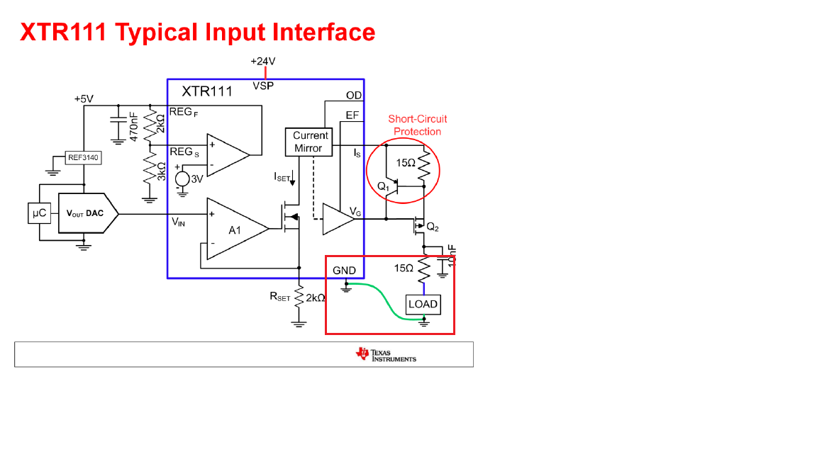

We are developing a product that uses the XTR111 to regulate the current for a 4-20mA circuit.
We have implemented the design as shown in the XTR111 documentation.
During testing, we found that the regulated current varies from one environment to another.
We could really use some help figuring out what to look at next.
With the first load circuit, which uses a 250-ohm resistor, the regulated current is right at 4 mA, as desired.
With the second load circuit, which uses a 5-ohm resistor, the regulated current is 5 mA instead of 4 mA. :(

  • Hi Alex,
    I was wondering how XTR111's GND and Load GND are connected, see the attached image below. Please tie both ground together, and let us know what is the test results. Also, place a bypass capacitor next to the load with a low ESR X7R ceramic type.
    Raymond
  • Raymond,
    Thanks for your response.
    In our design, and with both the test circuits, the grounds are common between the load and the XTR111.
    Also, the 10nF capacitor is in place as shown in your diagram.

  • We've discovered where the current measurement discrepancy comes from. Once we figured it out it seems kinda obvious.
    On the setup reading 5 mA, I didn't realize I had the current meter between the voltage source and the XTR111, so we were measuring the 4 mA + the current needed to power the XTR111.
    Moving forward we will design our measurement circuit to measure on the ground side.
    Thank you for your assistance. :)
