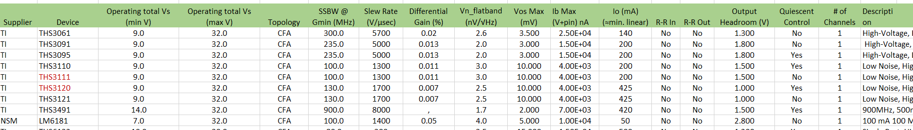

We need a replacement for the LM6181IN which has been discontinued. A pin-for-pin PDIP (8 pin DIP thru-hole) would be preferred, but an SMT part would work too.
Any thoughts?
Thanks!
Hello Hank,
Unfortunately, there are no current-feedback amplifiers in a PDIP package. Can you please provide the key parameters you are looking for?

Hello Hank,
In terms of parts that are similar to the LM6181, the THS3491 & THS3001 are the only two single-ended current feedback amplifiers that can go up to the same supply range of 32V. Both of these parts have greater bandwidth and slew rate capabilities in comparison to the LM6181.
If the supplies aren't a main concern there are other options as well. If you could provide me with a sim file or a schematic including the input/output requirements I can better help explore different options.
