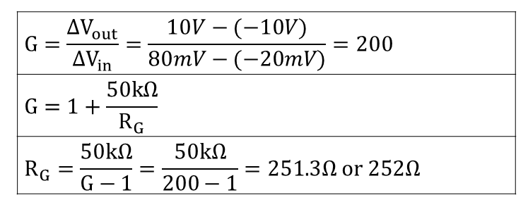

In the Quiz, why the answer is C?
1. Answer B : I think the gain is set correctly from my calculation.
2. Answer C: I think It is very important to use a buffer because the input to the INA Ref pin is low impedance and errors will occur if you directly connect the voltage divider to the Ref input.
