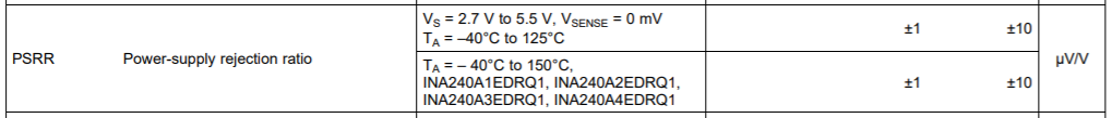

  • Hi Fujihara-san,
    The situation you described is guaranteed by this datasheet spec (psrr):
    A 0.5V supply shift results in a max 5uV input referred offset voltage. Practically, I would say it is negligible for most, if not all current sensing applications.
    Regards, Guang

  • Hi Nobuo,
    the gain is entirely determined by the resistors of internal differential amplifier. The supply voltage should not have any influence on the gain, provided the output of INA240 does not go into saturation (GND + 50mV <= VOUT <= VS - 200mV).
    Kai
  • Hi Fujihara-san,
    Kai is correct in that the decrease (variation in general) in supply does not contribute to gain error.
    Like mentioned in my previous post, it does contribute to the total error through an additional offset (for example, Max 5uV with given numbers).
    However this additional offset is independent of input (or output) voltage level, therefore it is has no bearing on gain and gain error.
    This will be true over temperature, if PSRR is constant. In reality, it probably is very close such that the temperature effect can be neglected.
    Regards, Guang
