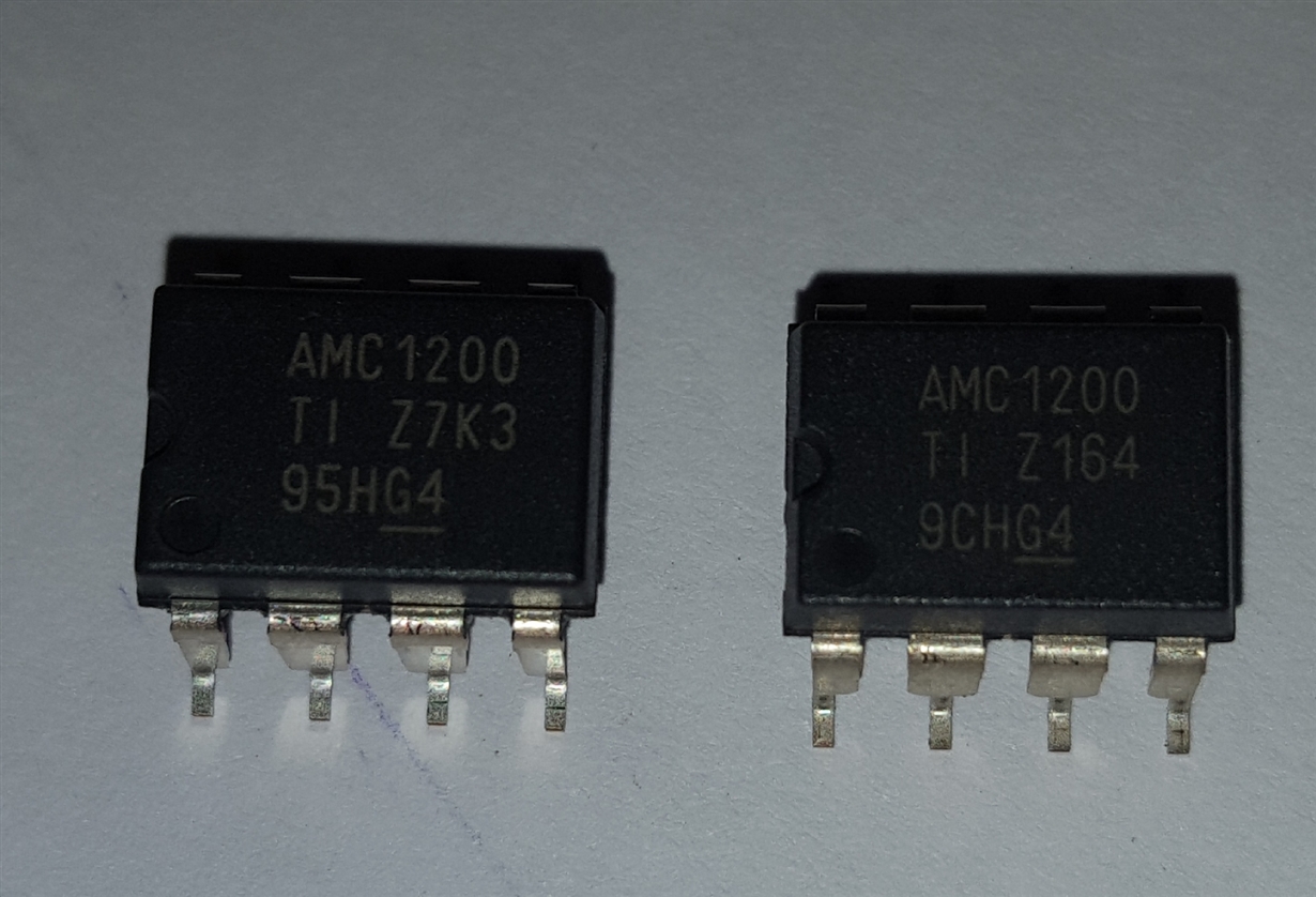

I have two different suppliers sourcing AMC1200 from two different countries. Would like to ensure that, both are genuine sources. No noticeable differences in performance while they come with different marking.

Hi Bharath!
Welcome to our e2e Forum! As long as you bought your AMC1200 devices through an authorized distributor, there should not be any concern about them being genuine devices. We have different assembly sites around the world so it is possible to have differences in markings. The 95 and 9C are date codes - 95 would be May 2019 and the 9C would December 2019. The alpha numeric string starting with 'Z' is part of a lot trace code (LTC).
I'll ask our quality team to verify the LTC's just to be on the safe side and will get back to you as soon as I can.
Hi Bharath,
I heard back from our quality team, these are valid LTCs (95Z7K3H, 9CZ164H).
