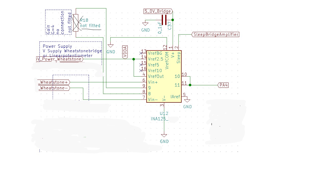

Hello, I use the INA125 and have some trouble with it. The Gain value dosen't change. Now I was thinking if the resistance of my Loadcell is maybe to low.
It has an resistance of 1kOHnm and is driven by the internal 2,5V. The gain factor is 4 ->No resistor. Can this maybe the case? It alsways drops out aroun 0,04V.
Even if there is no difference between V_in+ and V_in- . Does anybody have an idea why it is not working?
