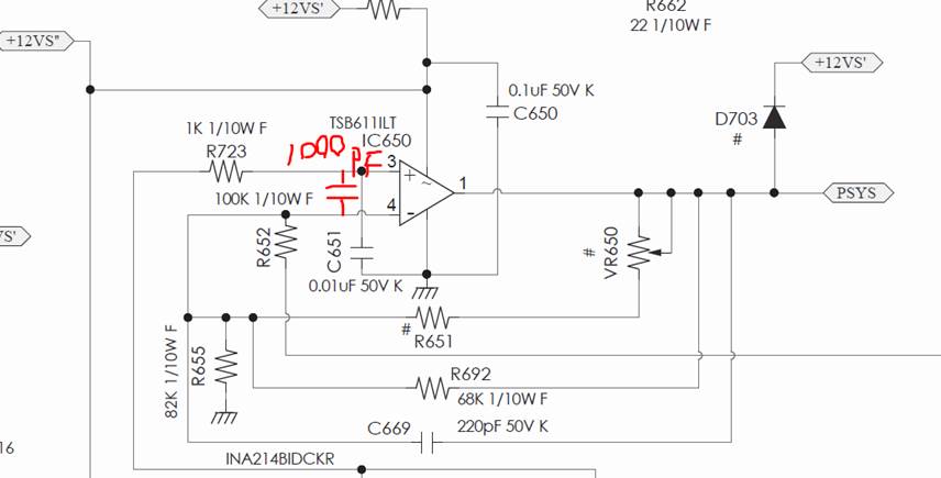

Hi Support team
Due to the large ripple noise at output, if a 1000Pf capacitor is added between the input V + V-, the noise can be significantly suppressed.
What is the reason that can explain this solution ??
In addition, any side effect if adding 1000Pf to the input ? Will it cause the circuit or IC to be unstable?

    I wouldn't do that because this can erode the phase margin of OPAmp and cause instability. Instead, I would modify the circuit like shown below, provided that the noise and ripple is coming from the inputs of differential amplifier. R5 and C3 could be increased. Also, R2 could be split into two resistors R6 and R9 and a suited low pass filtering cap C5 can be added then.
    Another issue is the signal routing arround the OPAmp. All the signal routing especially at the -input of OPAmp should be kept as short as possible.

    Kai is correct. Typically a capacitor across the input pins is not recommended because it can degrade the phase margin.
    It is important to find the source of your noise before making modifications to the circuit. Do you know where the excessive noise is coming from?
    Can you provide scope shots of before and after the 1000pF cap across the input pins?

  • Hi Tim & Kai
    thanks for valuable inputs,
    may i have recommend value of filtering cap C5?
  • Hi Red,
    hard to say without knowing the complete circuit :-)
    Maybe arround 1nF?
    Kai
  • Hi Red,
    What frequency range is the customer interested in using? As Kai mentioned, we can't just arbitrarily recommend a component value without know anything about the circuit design requirements.
