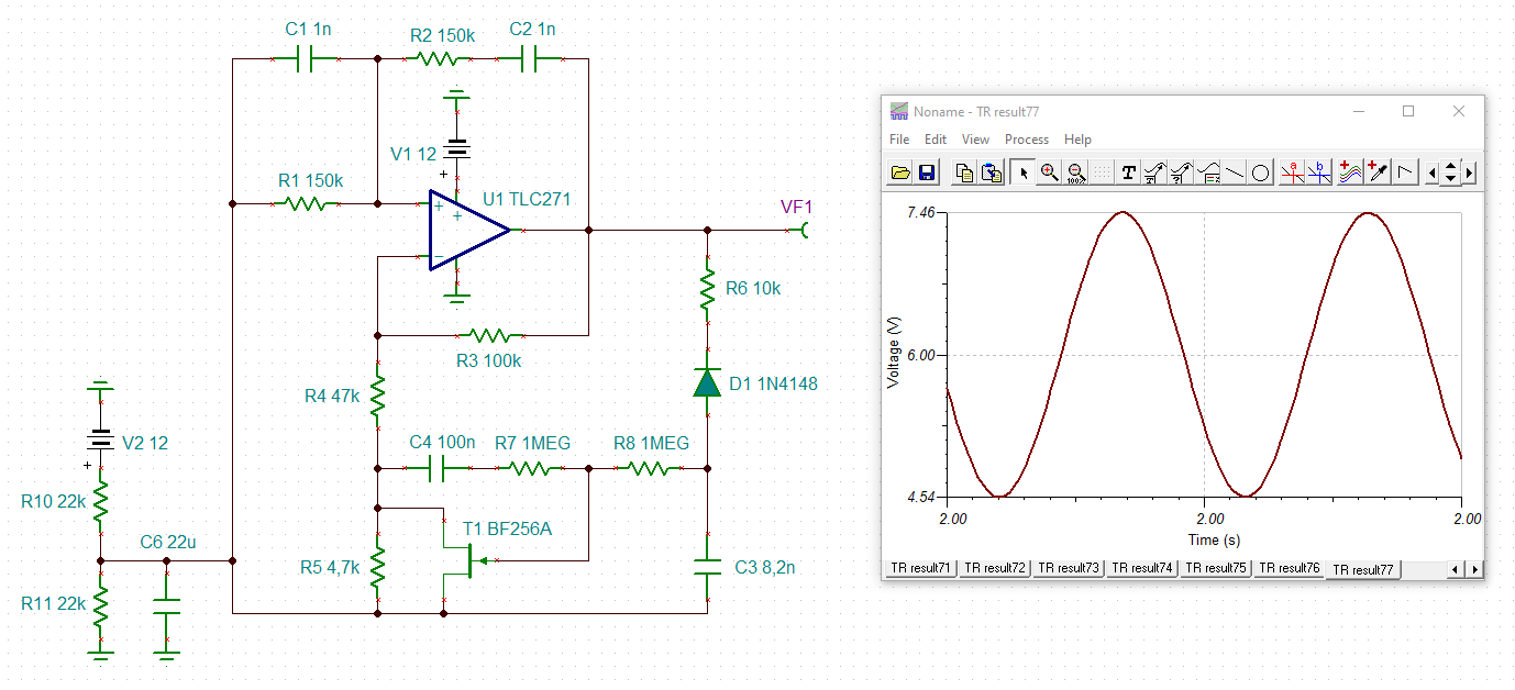

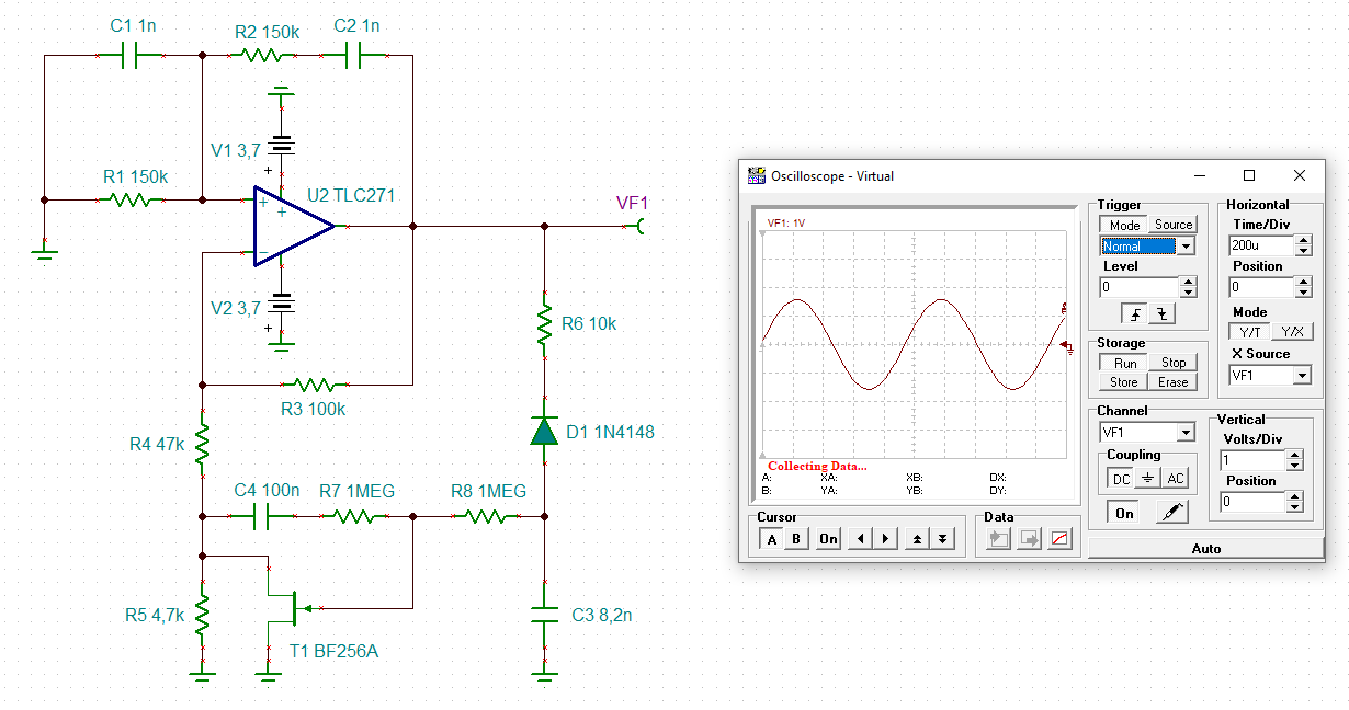

I am trying to use the oscilloscope in my own wein bridge oscillator the only problem is that the getting started note uses a predefined circuit instead of coming up with one from scratch. My circuit is completed except I do not have an output identifier defined. When I try to select one the ERC says that the thing is not grounded. The image that appears is a dotted box with a dotted line coming out of it not what is seen in the getting started pdf. I do not know how to connect one end to the output of the circuit and the other end to ground since the stupid thing really has no connection points. any help would be greatly appreciated.
I do not see any way to send you the circuit as there is no file transfer button to send the file to you.
