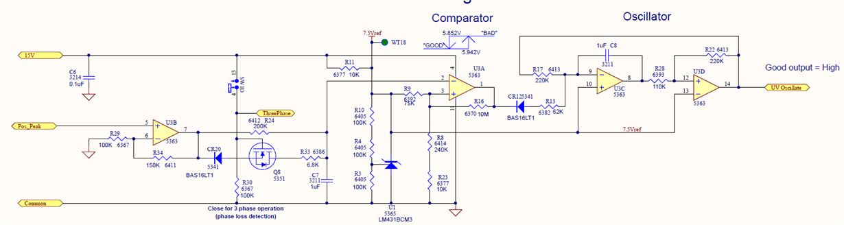

    The schematic can be seen below.  The first amp on the left is where I am seeing this problem.

    The schematic can be seen below.  The first amp on the left is where I see this issue.

    it sounds like that you suffer from latch-up. Latch-up can occur when you violate the absolute maximum ratings, even briefly. Specifically, the input and output pins must never be driven beyond the supply rails by more than 0.3V.
    Can you show a schematic?

    Not knowing more about your circuit, I would recommend the following modifications:
    I would clamp the input voltage to the rails by the help of BAV99. But this clamping only makes sense, if the supply voltage of LMC6024 cannot rise above 15.5V. So, the input signal should come from a circuit which is also powered by +15V.
    An additional current limiting resistor is inserted between this clamp and the input of LMC6024. Assuming a voltage drop of less than 1V across this 220R resistor gives a maximum current of less than 5mA into the input pin of LMC6024.
    There's another issue in your circuit. If the supply voltage can suddenly drop down to 0V, U3A and U3C are in danger. Then, the according 1µF caps also suddenly discharge through the ESD cells of LMC6024 at the input and for U3C also at the output. I have sketched the situation for U3C:
    This results in a current through the ESD cells which will exceed the absolute maximum ratings. A diode clamp and an additional current limiting resistor can also help in this situation.
    This protection is useful, if the +15V supply voltage goes down faster than about 220k x 1µF = 0.22s
    Kai

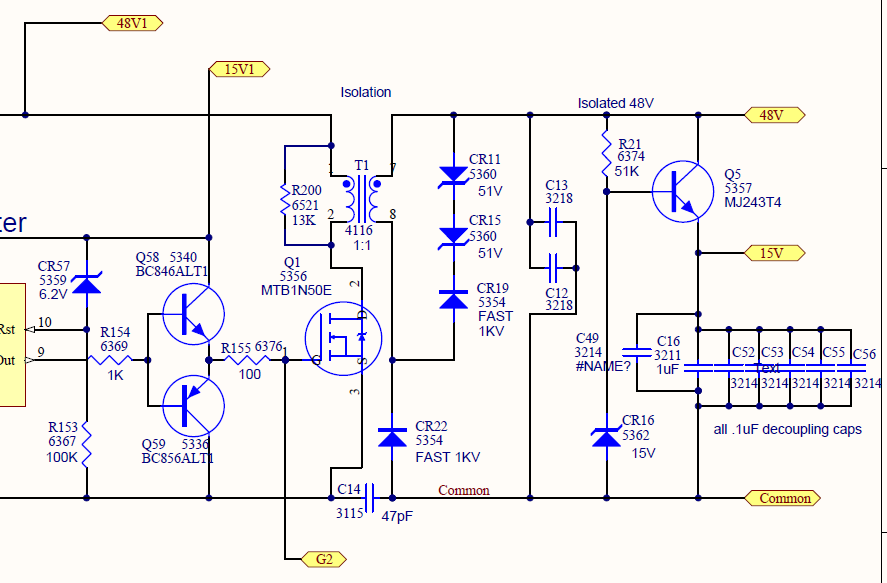

    The 15V is generated from a 15V Zener (BZX84C15).  The entire board is being powered from 480Y/277 3-phase.

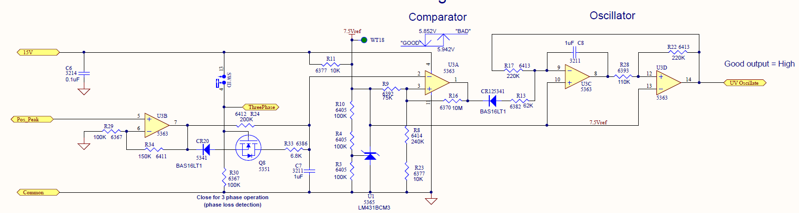

    Here is a schematic capture showing the 15V supply and the input (Pos Peak) of the amp of U3B.
    Only SW1B (opamp page) and SW1D (from the Peak Detects page) are closed.

  • Hi Paul,
    how big is Rx?
    Is C14 a Y-cap? Hhm, it's a bit small.
    The switching will contaminate signal ground ("Common"). Do you use a star-connected signal ground wiring in your setup?
    Kai

  • Hi Kai,
    Thanks for the feedback.  The current schematic has nothing for resistance where you drew in Rx.  I threw in a 100K there for testing.

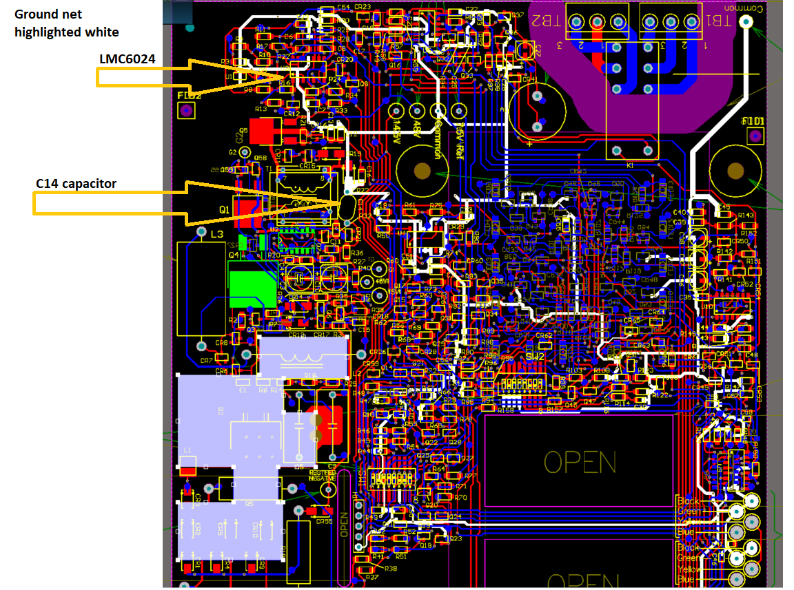

    Yes, C14 is an AC line rated disc capacitor part number VY2470K29U2JS6
    The grounding path could certainly be cleaned up.  As you can see from the PCB screenshot below it looks like no special attention was given to grounding and there are several unnecessary ground loops.

    The white wires are signal ground ("Common"), as you wrote. My question, and it is an important one, is: Does the printed circuit board provide a solid ground plane?
    Kai
  • Hi Kai,
    No ground plane at all - only the signal ground highlighted in white.

    oops! Not having a ground plane is really bad. This can be the cause of trouble.
    Some switchings within the circit can generate inductive kick backs on the snaky and inductive ground traces. This can shift the ground potential and cause latch-up.
    Kai
