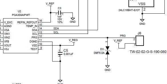

    There is only one TVS diode in the path of the PRG pin. I have attached snip schematic of PRG attached.
    I did also try to reduce the baud rate to 4800 and it behaved in same fashion.
    But we tried Powering on at 125C and PGAoutput is normal after power on reset. this indicates state machine and reading from EEPROM is working internally.
    Only External communication is still not working.

  • Hi Raghavendra,
    please post the schematic snippet again. I didn't come through.

  • HI Raghavedra,
    From the schematic point of view, based on the schematic symbol, the schematic appears to show a bidirectional TVS diode (although the part number suggests the TVS diode is uni-directional).  Using a unidirectional TVS diode with a lower breakdown (or maximum breakdown voltage of 7.0V) will protect the device better.  For example, unidirectional SMF5.0A offers a lower max breakdown of 7.00 and minimum breakdown of 6.40V.  The SMF6.0 has a max breakdown of 7.37V that exceeds slightly the absolute max rating of the PGA309.
    Consider adding a 500Ohm resistor in series between the TVS diode and connector J8, this will help reducing the current into the TVS protection diode during a transient or overvoltage condition, and reduce any over-voltage seen by the PGA309.  Also, placing a parallel capacitor will help with EMI filtering protection and also help slow down any fast over voltage transient.
    One suggestion is to verify 1-wire communication placing an oscilloscope right at the PRG pin while the issue occurs at Hot temperature.  If you already have verified that there is no intermittent connection issue on the 1-wire interface at hot temperature, then it is possible that the internal ESD structure may have been damaged or degraded by an over-voltage or ESD event, manifesting the issue at hot temperature.
