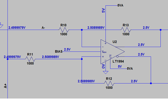

Am simulating some of analog circuits in LT spice , So i have used LT1994 part and observed result are matching with my calculated values.

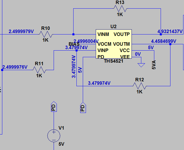

When i replace LT1994 part into TI part THS5421 i could see difference in output voltage/Gain with THS4521. I believe some issue in THS4521 model. Could you please help us and sort it out
Please see the below image for better understanding.
Simulation With LT1994
Simulation With THS5421:

  • Hi Kai,
    Yes i agree THS4521 works fine in TINIA TI software, But there is model mismatch between TI site and model available in TINA TI folder.
     I downloaded the Pspice model from TI site and viewed in net list viewer are  shown below., And then converted file to LTspice model for simulation
    Second: In TINA ti  tool i selected the THS4521 part and viewed the model in net list viewer and find some difference in spice model. Please see the below image:
    Could you please share me correct working spice model of THS4521, Since i need to use the model in LTspice.

  • The THS4521 had many performance and model issues -the THS4551 device and model fixed all of that. Most folks here are not likely going to help much on LTSpice problems, but you can try this .lib version of the original THS4551 model (2016). The newest one (2019) is not correct on noise and went to a newer template that seems to not work in LTSpice,
    2727.THS4551.lib
  • Hello Bala,
    I recommend using the models found on the TI site rather than those found within TINA itself. This will ensure you are using the most up to date version. We cannot support issues specifically to LTspice, however the model should have no problem working on TINA or Pspice. If you need to use LTspice maybe try the older version found on TINA? or as Michael suggested use a part with similar functionality such as the THS4551.
    Hasan Babiker
  • True, and normally what I do as well - however, I have been noticing the latest GWL models seem to always fail in LTSpice - the latest for the THS4521 is 2016 so pre-GWL.
    His question was getting through a LTSpice run problem - might get past that using that older THS4551 .lib model I sent. (also, the last I checked last week, the updated THS4551 GWL model is still too low on input noise).
  • Hi Michael,
    THS4551 models works fine thank you for support.
    Bala
