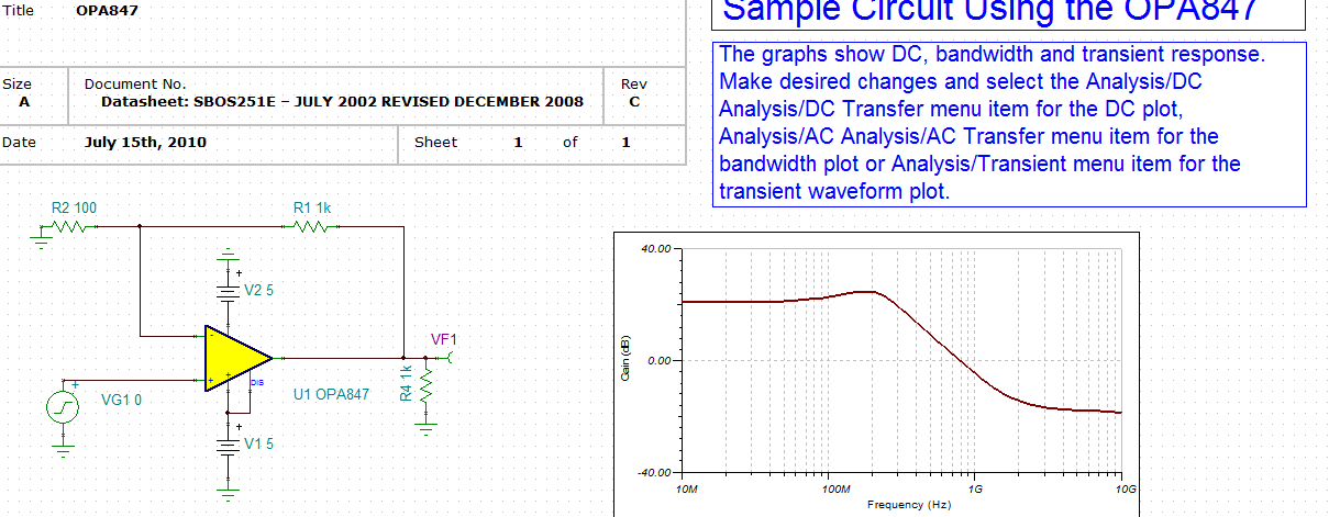

    If I open the Rev C TINA model, circa 2008 and still has the disable,
