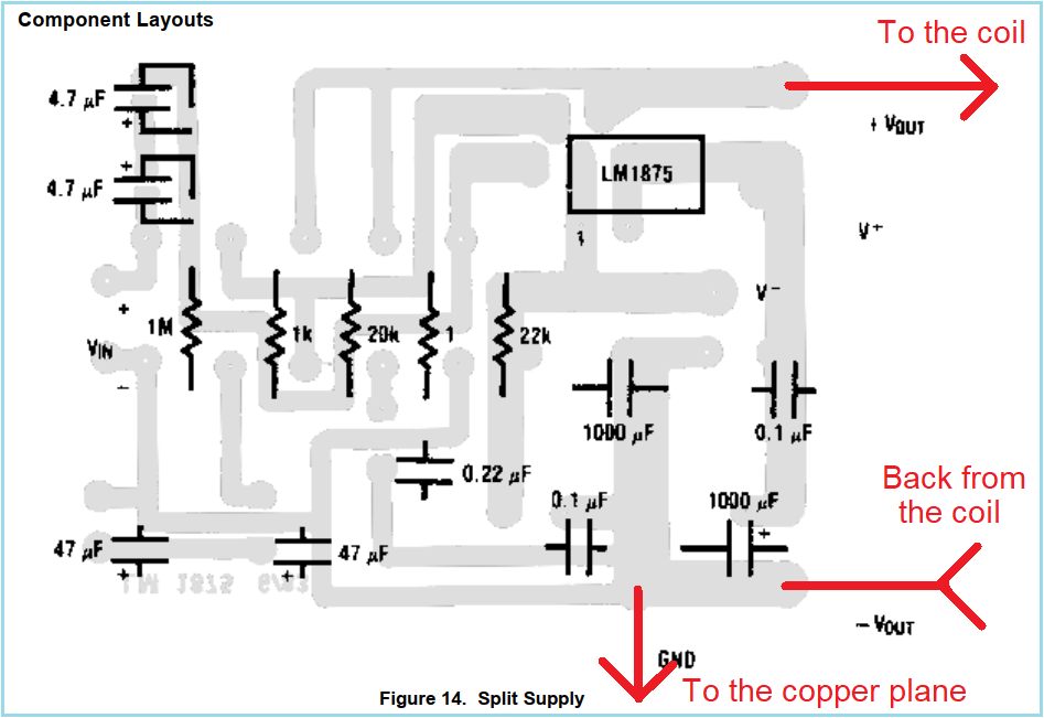

  • Hi Matthew,
    I would build up this circuit below thrice:
    Or eventually this improved version with input filtering:
    Use the layout shown in figure 14 of datasheet.
    A very nice layout and a hum loop avoiding circuit can also be seen here:
    Mount these three printed circuit boards upright and next to each other onto a copper-laminated circuit board and use the copper plane of this circuit board as central ground "point".
    Connect the signals to and from the coils as shown below:
    Feed the input signal to the left of layout ("Vin") and also connect the signal ground there ("-"). Avoid the input signals forming any loop areas. Best use screened cables for the input signals.
    I would run input signals of sufficient high amplitudes to the boards and divide them down to the appropriate level by the help of a resistive voltage divider mounted directly at the input of LM1875.
    Kai
