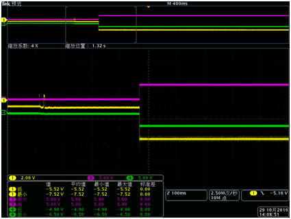

customer's main power stage is as below:
And the sampling circuit to sense +VDC(up to +400V max) and -VDC are shown below:
U24 is LM358B, the power supply is ±5V。±5V is generated through UCC28C45 from +VDC. So GND is isolated from GND_AUX.
The first time we connect 3 phase AC input to grid, we measured the waveform as below:
purple- +5V supply, yellow- pin7 of U24, green- -5V supply.
The output of the OPA pin 7 should be -250*(-5.6k/850k)=1.64V which should be positive, but we get negative output with pin 7.
green and purple- power supply, blue- -VDC(-400P in the schematic), yellow- pin 6 of U24.
We can see that -VDC signal comes before ±5V is supplied to OPA.
And then we disconnect AC input, wait for DC BUS decrease and aux power for ±5V for LM358B shutdown, and then we reconnect AC input. This time the output is normal as shown below:
yellow- pin7 the other 2 are ±5V.
we also measured pin 6(yellow) and -VDC(blue, it's reversed so the waveform is positive).
-VDC is measured by differential probe connecting to GND_AUX and -VDC.
This time we can see that -VDC signal comes at the same time with ±5V power supply.
So it seems that the problem is caused by -VDC comes before the power supply of OPA. But according to the waveform, pin 6 is 0V before ±5V is supplied to LM358B, which doesn't go beyond the recommended operating conditions.
Why would LM358B behaves abnormal in such situation?

  • Howard,
    I suspect the voltage difference between the different ground systems may be changing the common mode voltage. Can you measure the voltage pins 5, 6, and 7 when the op amp is in the unwanted output state?
  • pin 5 and pin 6 is around -0.5V, pin 7 is -5V. Looks like the OPA is saturated somehow.

  • Howard,
    If both inputs are the same then the op amp did it's job. Did you keep a meter on pin 7 when you checked pins 5 and 6? Or at least re checked that pin 7 was still -5V?
    Another odd thing, I don't think output could be -5V with input at -0.5V and feedback resistor is 5.6k ; that would require (-0.5V - -5V)/5.6k = 804uA of sink current and the LM358B VOL is about GND[pin] + 0.7V at that current. -4.3V would have been possible, but -5V is not possible (barring a short or pin 4 not being -5V).

  • Kai,
    thank you.
    Personally I guess the problem is latch issue, I'll test on our own board by giving signal to input prior to the voltage supply.
    The problem you listed about the common mode voltage should also be a problem for AS358, but it doesn't.
  • Howard,
    There will be different response for input voltage below the GND pin for each design for 358. On one design, the output may go high. On other design device, the output may go low. For most (may be all) the 358 will resume normal (closed loop) operation once the input voltages return to valid input voltages. The same thing can happen for input voltage above VCC-2V.
