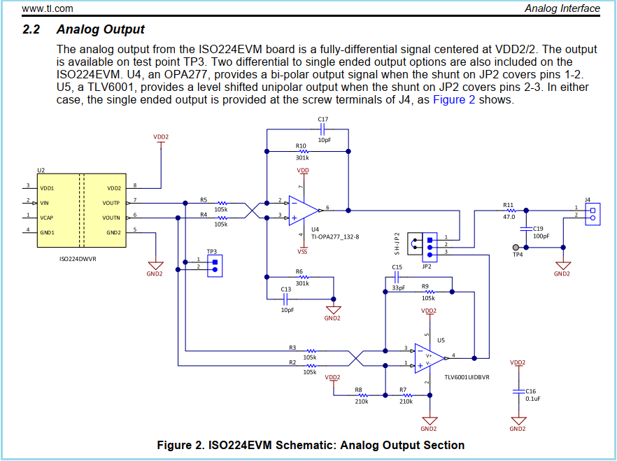

I have an issue with using ISO224. The thing is that I measured an output ripple of around 110kHz and 700mV at the output of ISO224(OUTP to OUTN).
The voltage for Vdd1 and Vdd2 are both 5V and measured with negligible ripple. The input is a DC voltage around 7.2 V DC.
I tried to disconnect everything connected OUTP and OUTN, which does not help solve it. Also, I tried another ISO224 chip, which show the same results.
Any idea about the issue?
