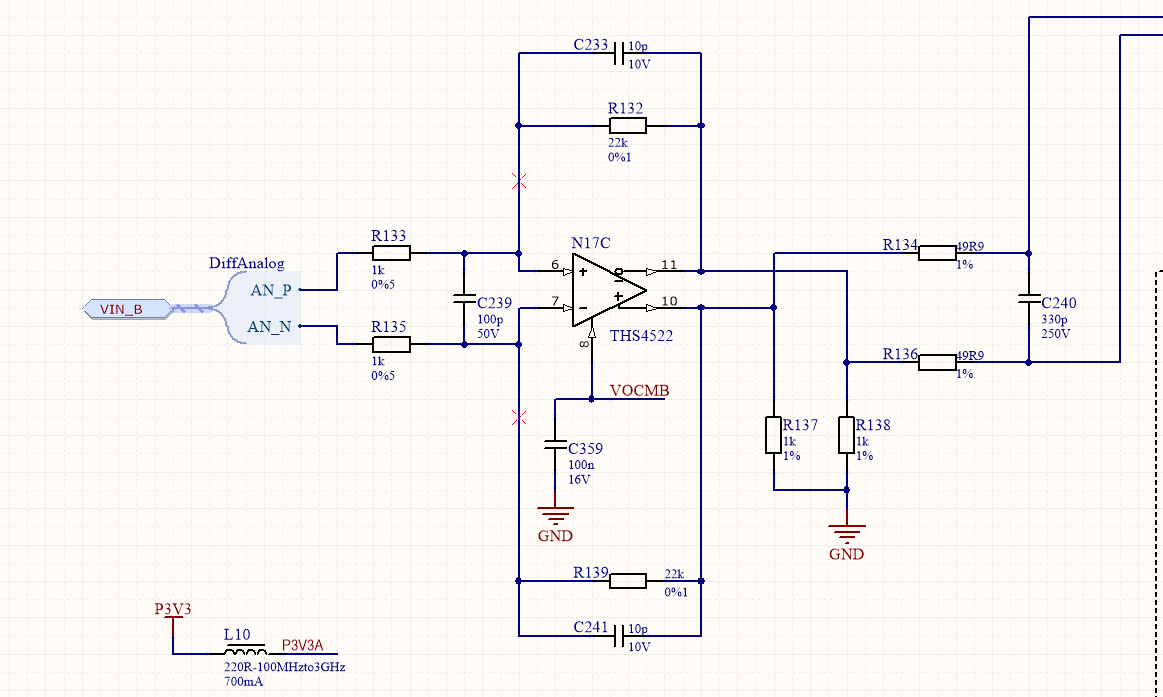

I suffer massive thermal drift on THS4522 used as a current shunt (1mR) amplifier to 25msps ADC.
it has 22x amplification factor (1k in, 22k FB). And designed bandwidth (-3dB) at ~700kHz.
Typical output is then 22mV @ 1A on shunt, while I thermal drift can reach +/-1mV according DS it shall be at least 100x lower.
For positive current, voltage on shunt (OpAmp) is always positive, so negative offset rail is not the case.

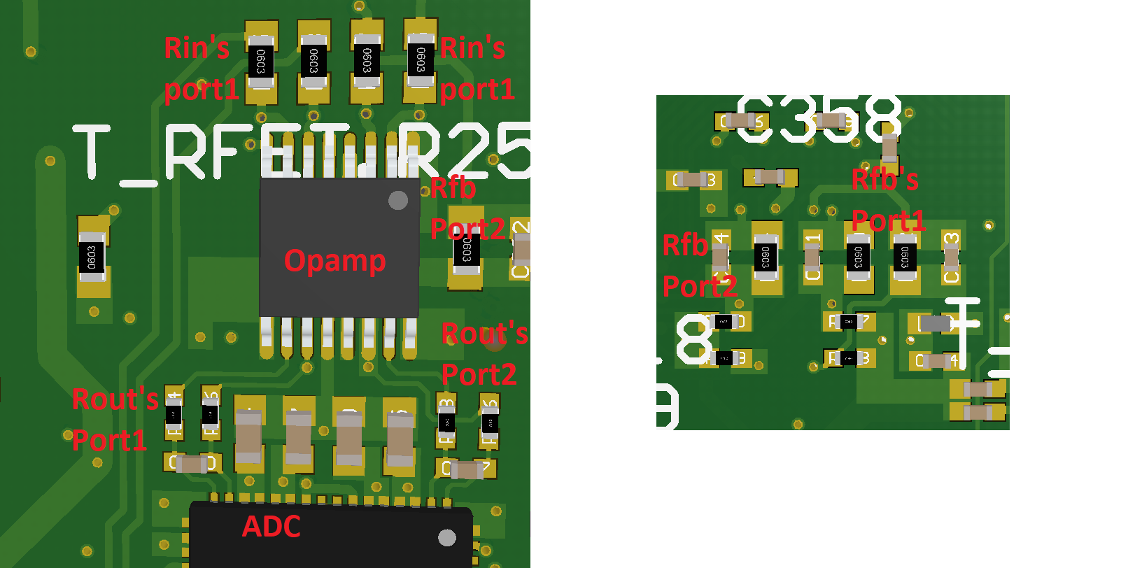

Both gates of OpAmp uses same current sensing circuitry, and both suffer by drift, but from device to device it is once more on Port1 on other device it is stronger on Port2.
I tested that aggressor is opamp by touching it by tip of soldering iron to plastic body (iron was running at 70C) and cooling down by fan.
Funny is that I use same OpAmp for similar purpose with 1k/47k configuration with no issue (but only 2 Msps ADC).
What I have tested was:
- change of FB resistors (20k, 38k) - no impact
- switched of ADC to see impact of SAR input capacitance – no impact
I have no idea where the problem and would be grateful for any similar experience or tip where to look at.
Thanx
Peter
schematic:
