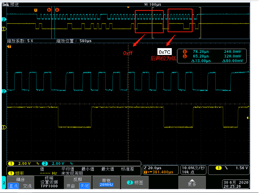

Hi Team,
The customer sets the current value of INA233 to an overcurrent state. He uses a multimeter to test that the voltage across Rshunt was 118mV, which was greater than the maximum measurement range. But the printed code is 31999 (0x7CFF), not 32768 (0x7FFF). Would you possible to check the reason?

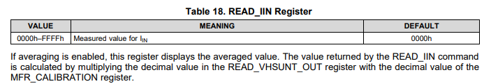

    Register 89h returns calculated current as explained in this paragraph:
    The value is scaled based on the calibration register. Therefore an out-of-range Vshunt does not necessarily produce an out-of-range current.
    For a valid verification, please read register D1h, which is a direct reflection of the Vshunt and customer should see its value overflows.
    Regards, Guang
  • Hi Guang,
    He read it with Vshunt, it is accurate.
    And he has further questions and needs help. Is he able to change the value of the calibration register, and then the maximum value of READ_IIN will change accordingly? He uses INA233 for over-current protection. When the current value exceeds 100mA, Alert will respond. After he passes the calculation, the selected threshold is 0x7DFF. However, in this case, it can only count up to 0x7CFF, and protect it before reaching the set overcurrent point. Customer would like to know how to resolve it?

  • Hi Annie,
    This video talks about how to program power monitors, with INA233 being used as an example. On slide #6 the equations under “FYI only - How internal register values are calculated by power monitors” can be used to address your customer’s question. If you find yourself spending too much time on it, please provide a couple pieces of  information and I'll be more than happy to make the calculation for you:
    (1)   Shunt resistor value
    (2)   Calibration register value
    Regards, Guang
