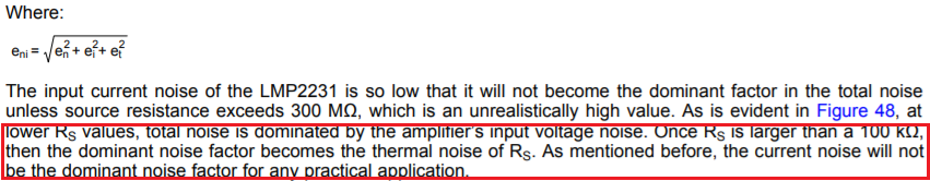

    High value resistor in series at non-inverting input will certain help, but I am concerned about the thermal noise as shown below. Since this is buffer configuration, the thermal noise may not be amplified significantly, but it can be an unwanted noise source.

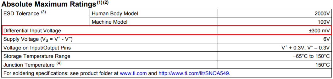

    What is your LMP2231's voltage rails? Did you investigate what was damaged in the LMP2231 part. My speculation in this is that the part may be damaged due to larger differential input voltage difference in the application (perhaps you already pointed out, but it was not clear). I would suggest to pay attention of the V+ and V- voltage delta during power on and power off process.

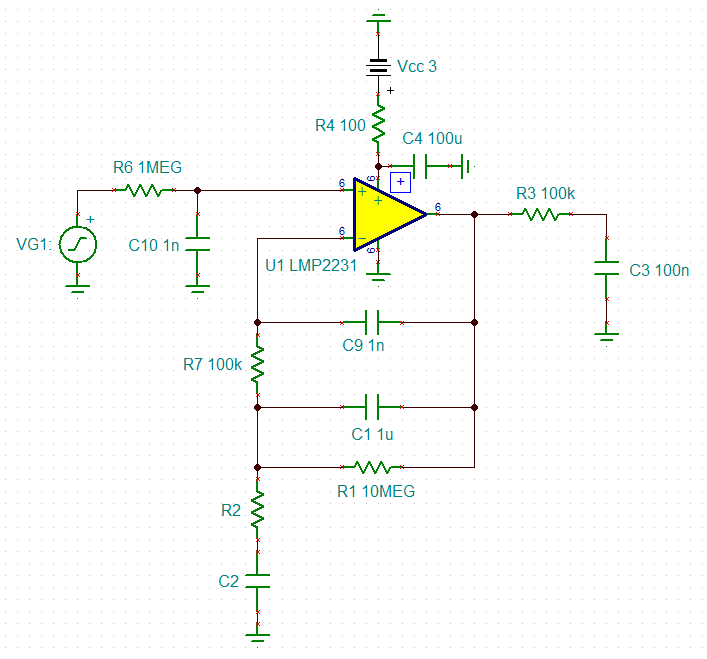

    Do you want to show us your schematic?
    And what do you want to connect to the output of LMP2231, if I may repeat my earlier question?
    Kai
  • The output of the LMP2231 is connected to a cmos input a/d converter through a 100K resistor.
    How can I send you an image of the schematic?

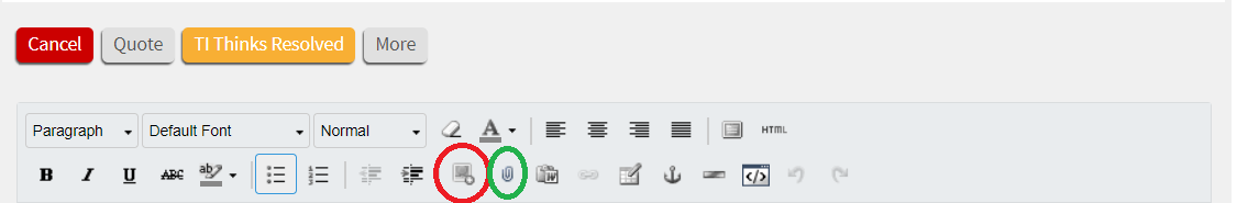

  • Hi Robert,
    You may use the icon circled in red to upload image file, or the icon in green to upload the file.
    This is a public forum. If you want to privacy, you may request a friendship connection via private E2E message; and I will forward your email to Kai. Or you may send a friendship request to Kai, but I have not tried that options.

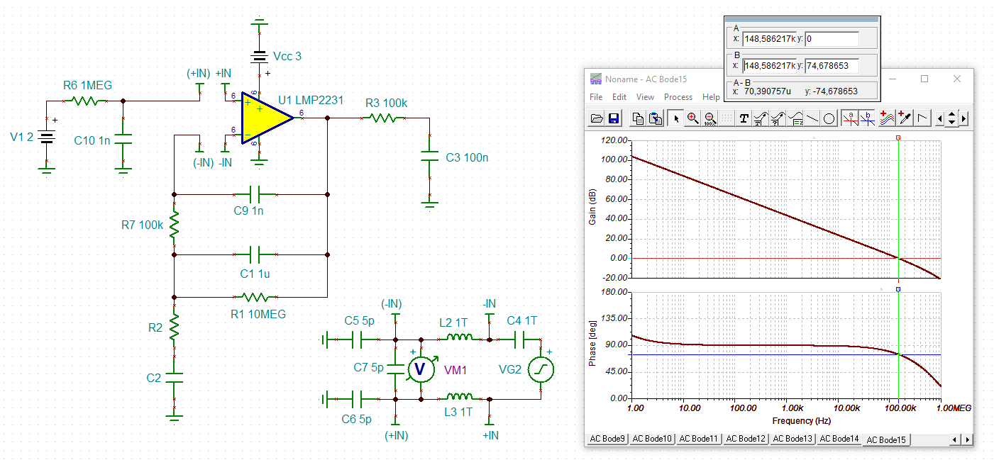

  • Hi Robert,
    I would do it this way:
    The phase stability analysis shows a very good phase margin of 75°:
    Kai
