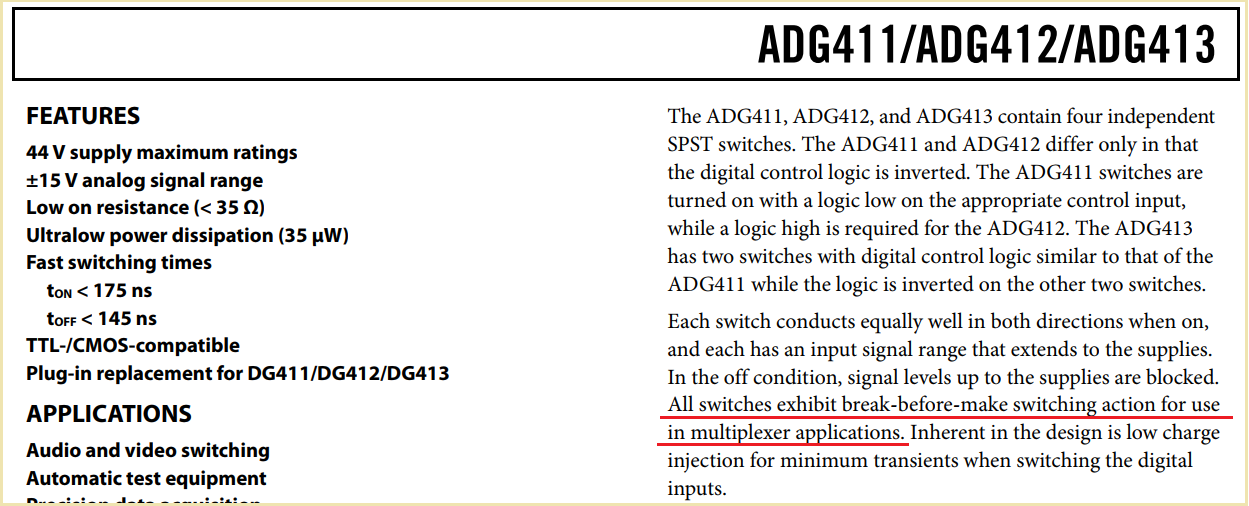

  • Hi Hung,
    the ADG411 is a break-before-make mux:
    So there should not be any issue with your circuit.
    Also, there should not be any stability problem with the TLV274. The maximum capacitive load in your circuit would be 62pF. Even with this load capacitance the TLV274 looks very stable:

    I confirmed with the customer but the customer said ADG411 seems don't have break-before-make function.
    So to confirm the phase margin, I could just simulate in TINA-TI. Sorry to ask such a simple question.
    And I would like to know why you use 62pF here as an example, since I didn't find the value after looking up in datasheet of TLV274 and other components.
    BTW, I answered to the customer and maybe I can simulate by myself when I get the capacitor value he wants to use.
  • Hi Hung,
    regarding the break-before-make issue I see no reason to doubt the datasheet of ADG411. Eventually the customer might want to contact AD directly?
    62pF is the maximum load capacitance which one of the four TLV274 sees due to the parasitic capacitances of the drain and source pins of ADG411. 9pF on each side of an opened switch and 35pF on a closed switch gives 3 x 9pF + 35pF = 62pF.

  • Hi Kai
    The customer contacted with ADI and it seems ADG411 doesn't have that function.
