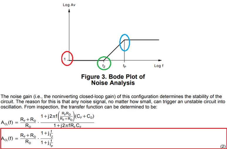

Hi Team,
A customer is asking for a mathematical derivation of Equation 2 in the SBOA055A Application Report. Do we have documents that explains the derivation of equation 2?
https://www.ti.com/lit/an/sboa055a/sboa055a.pdf?

Hi Danilo,
TI Support is asking me to reply the derivation of equation 2, even though Michael is answered.
Figure 3 is the transfer function or bode plot in graphic form, where DC, fz and fp are break points as frequency is increasing.
Please let me know if you have questions
Raymond
