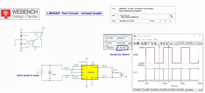

we used the THS4513 op amp in our circuit to amplify a differential signal with approx. 40V/V. By now, we switched to the LMH5401 due to the better GBP and thought it would work the same way (beside the layout changes of course). The LMH5401 was simulated in LTSpice and Tina TI to check if it was capable of delivering a required gain of 40 V/V, cause the THS4313 does so. You can find the simulation results in the following:
As you can see, the LMH5401 fails to deliver the set gain of 40 V/V. The same result was achieved with smaller resistors (10 Ohms and 375+25 Ohms). Where does that come from?

    It looks like you are measuring the output in your TINA simulation incorrectly. In the picture you provided, the meter is measuring the difference between the common-mode and OUTN, to measure the true differential output you will want to measure across both R9 & R10 as shown below:

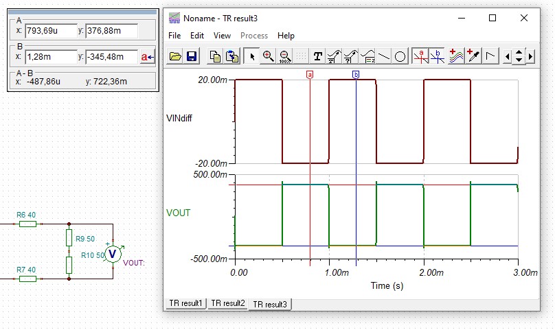

    thanks for your suggestion. I changed the meter, but the result is still the same.
    The voltage across R9 and R10 is 722mV, which actually should be 800mV instead (40mV at the input, 40 V/V gain and voltage divider of 2). I don't know the internal circuit or how accurate the simulation model is, but this isn't how it should work, right?
    More importantly, our "real world" test circuit results don't even fit the simulation results for higher gains (see the table in my previous post).

    The LMH5401 isn't particularly suited for large gain setting resistors which you mentioned was hard requirement for your design. Note that the differential input resistance is only 4600-ohms. Note that all configurations in the datasheet are designed with 50-ohm matching in mind. Also if you notice in table 1 of the datasheet, the feedback resistance is what is increased when adjusting to a higher gain rather than Rg.
