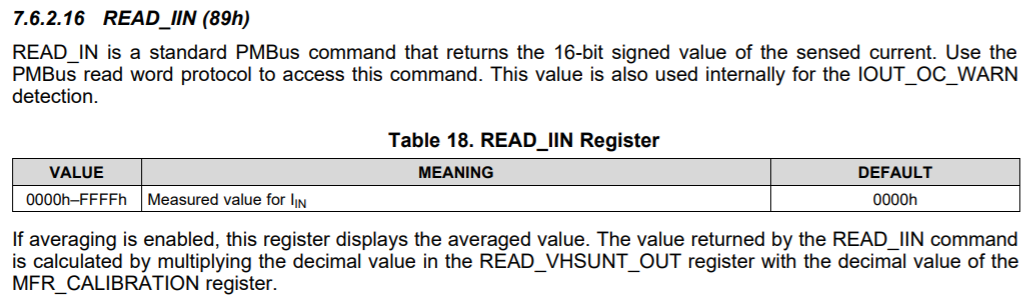

6.Read the READ_INN value and the vlaue is  7FFF/32767 which I suppose is abnormal.

    I think there is an error in either how the calibration value is being written to the device or an error with how you are measuring the load current to be 2A.
    With Vshunt = 27.5mV, this mean load is 27.5mV/0.5mΩ = 55A, which well exceeds the 15A to 30A max expected current. This in turn would cause overflow in the current measurement register of the INA233.
    Could you read back the calibration register after writing to it to make sure it is working correctly.
    How does this load current return to a ground that is connected to the INA233 ground? Basically, are you sure the ground of INA233 is the same as the ground of the 2A source?

    2. If you would rather transfer the Vshunt->load current mathematical processing from the INA233 to the host, then you can certainly do that. There should be two ways. First, you could take the Vshunt and multiply it by the calibration value (see below excerpt from datasheet) or you could convert it to decimal first and then divide by the shunt resistor value. Both are effectively the same thing.
